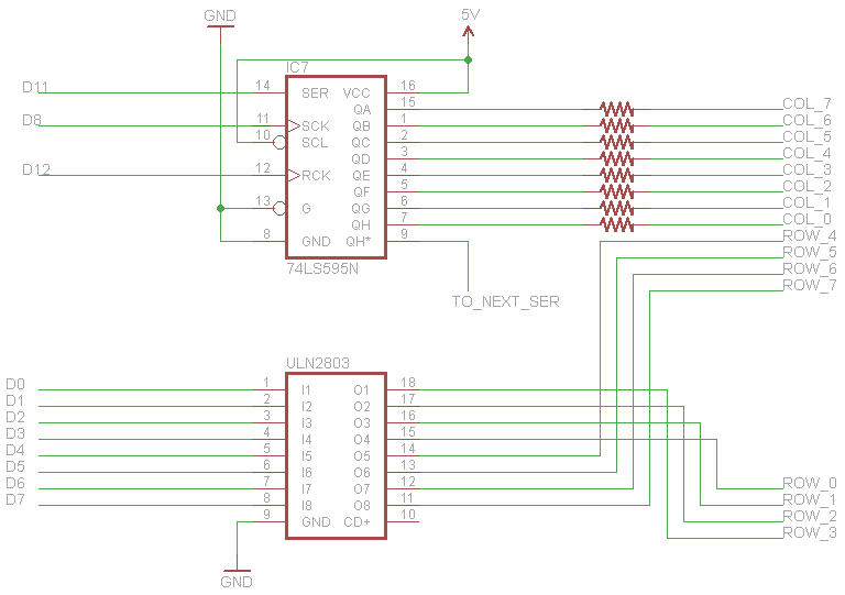

Step 4: Designing the Drivers
At first thought, driving an LED matrix is a simple endeavor. Simply hook the anodes to one set of microcontroller (uC) pins and the cathodes to another and there you go, right? Well that would be nice but it's a big problem for two reasons. One, the if we wanted to expand this to large matrices we would quickly run out of pins. Second, when multiple LEDs are lit up at the same time with set-up we run the risk of the current draw on the uC pins being so high that we damage unit. So how do we get around these problems? Which the use of extra integrated circuits and little trick in the software.
Here we'll be discussing how hardware helps us solve the above problems and we'll discuss the software trick a little later on.
So I know that my LED Etch-a-Sketch will require four 8x8 LED matrices. That means I have 256 LEDs that need to be individually addressed. That's quite a bit. So how to we do it? Well first we need to understand how the LED matrix works. The particular matrix I used is called a common cathode LED matrix. It may make understanding what this means if I add a little to the name. Lets call it a common cathode row LED. So now we know that all the cathodes in each row are on the same line (see the first image). This allows us to control a single LED by simply supplying a positive voltage to the column and ground to the row corresponding to the LED we want lit. For example if we want to light the LED at (4,4) we would apply ground to row 4 and a positive voltage to column 4 as seen in the second image. From this we know we need so control all the column lines. But what about the row lines? If we just tied all these to ground then we would never be able to have different LEDs lit on each row. This tells us that we also need to control the row lines.
We'll look at the entire 16x16 display as an 8x32 display as that's how it will be wired up. You can see this in the third image above. To control a display of this type we will need to control 32 lines for the columns and 8 for the rows. Row control is no problem; we have eight pins available to us on the uC. The only thing to be concerned about is how to sink the current without damaging the uC. I'll address that in a second. But first let's figure out how we are going to control 32 lines when we clearly don't have 32 uC pins available.
The trick is to use the handy 74HC595 serial-in parallel-out 8-bit shift register, or, as I'll refer to it from now on, the 595. This IC allows us to serially send a byte of data to be stored in the register and then when signaled that data will appear in parallel (at the same time) on the output pins. It also allows for multiple 595s to be cascaded or connected together to accept an input larger than 8-bits. I'm not going to send time discussing the theory behind this device, as there are many resources available online that will do it. But at this point I'm sure you can guess where we are going with this. If we cascade four of these 595s together we can serially control all 32 column lines with just a few uC pins.
Let's quickly get back to the rows. As mentioned above we need to be careful not to send all the current through the uC to ground so we'll use a ULN2803 at each matrix. This will allow us to control the row lines while at the same time sinking the current.
We'll talk about how these ICs is used in conjunction with the software to successfully control the the LED matrices. But first let's get everything wired up properly.
Step 5: Combining the Logic and the Driver
This step is the simple matter of connecting everything together. Unfortunately doing this on bread boards is quite messy as you can see in the first photo. Alas, it had to be done, at least in my opinion.
First off, let's go ahead and get the ULN2803s hooked up as it about as simple as it gets. If we look at the datasheet for this IC we see it has 18 pins, 8 will be for out control lines from the uC, another 8 will be connected to the rows of the LED matrices, one pin is ground, and one is common which we will be leaving disconnected here. The inputs 1B - 8B (pins 1-8) will be connected to the Port D of our ATmega328p in the order where PD0 connects to 1B and so on. The outputs 1C - 8C (pins 18-11) will be connected to the rows of the LED matrices where 1C connects to row one and so on. Lastly, the ground pin connects to ground. You can see this in the schematic above. (You're probably going to want to view this full size).
Here's where it gets interesting, because not do the 595s need to connect to the uC, but they also need to connect to each other. First let's get the connection to the uC squared away. In order to interface with the 595s we will be using the SPI bus on the ATmega328p. This involves the use of specials pins on the uC labeled SCK (PB5), MISO (PB4), MOSI (PB3), and SS (PB2). The SCK is the serial clock; MOSI stands for master output slave input, MISO stands for master input slave output; and SS the slave select. Since our ATmega328p will be the master and will only be outputting data we will not use the MISO pin. I'm going to go into the details of the SPI bus because quite frankly I don't know that much, but understanding all its complexities is not necessary to completing this project. I will, however, discuss what is going one here when we get to the software step. For now, connect the SCK (PB5) from the uC to SRCLK (pin 11) and SS (PB2) from the uC to RCLK (pin 12) for each 595. Then connect MOSI (PB3) from the uC to SER (pin 14) of the first display's 595 as shown in the schematic. We can cascade the 595s by connecting the QH' (pin 9) of the first 595 to the SER pin of the second and continue as in the schematic. Next you need to connect the OE (pin 13) to ground to enable the output. And the SRCLR (pin 10) to positive supply voltage so that we never clear the serial data. To connect the 595s to the LED matrices, the pins go in the opposite order that you expect. Here you want to connect QA to the that controls column 8, QB the pin that controls column 7 and so on. We're doing this because the most significant bit (MSB) is on the left. I'll address this more when we talk about the software.
A note, the datasheet for the LED matrices are not very clear on what pins are what. The last image on this step, as bad as my drawing is, shows the pinouts and connection for the components. There is a YS printed on one side of of the LED matrices to indicate the top direction and the YS on drawing should match it.
