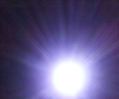

Step 3: Final Results:
One with 18 LEDs (6 * an led triplet) and other one with 9 !

Step 5: Update - Final Pics
Ok ! So the lighted pics that many people wanted to see. I hope those who are proficient with AC Mains will make one.
Important Note & Disclaimer: DO NOT ATTEMPT, if you do not have sufficient knowledge & experience of working with AC Mains.

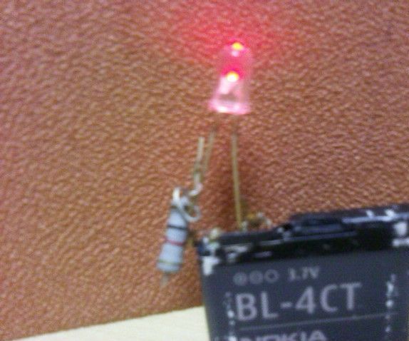

Tip 1:
U can use this simple wire connector concept even for ur 6V & 9V projects and avoid soldering (allergy)!
Now you can always make a project instead of just reading them!
