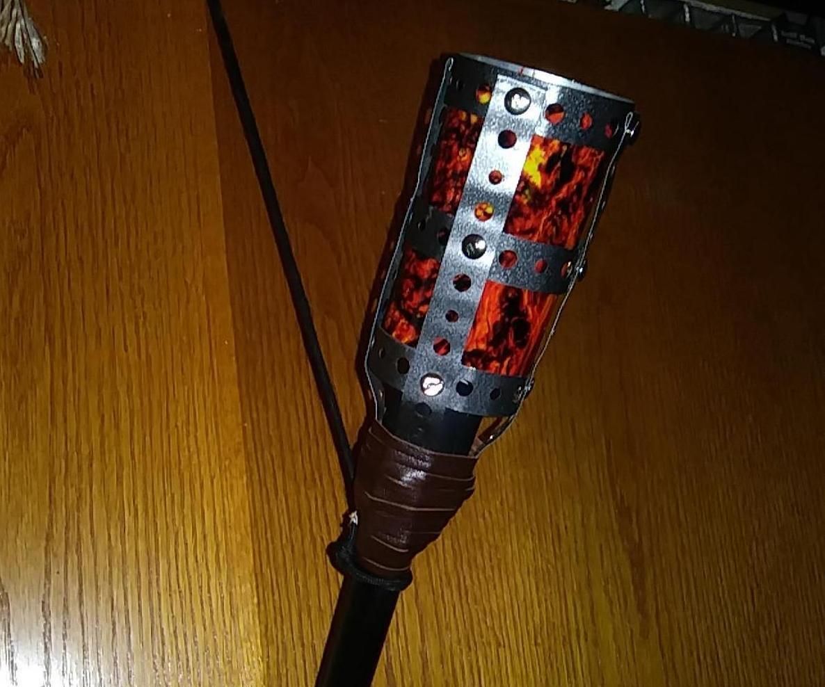

Step 5: Metal Shroud for Torch
the patterned aluminum sheet i used was 12" by 24" [30cm by 60cm]. i cut it into six pieces each 6" by 8" [15cm by 20cm]. the light bulbs base had a circumference of about 8" [15cm]. i folded the pieces into six shrouds for the torches.
https://smile.amazon.com/gp/product/B00E7XT35Y/ref=ppx_yo_dt_b_asin_title_o01_s00?ie=UTF8&psc=1
Step 6: Add Metal Shroud to Light Bulb Base
i drilled three holes in the base and lined up matching three holes in the metal shroud and bolted together
Step 7: Attach Base of Light Socket to Rod
split the rod to allow base to fit. drill holes and fasten together. i used leather rivets. attach wire to base. the light sockets i used came with a cord tightener on the base, however, i did not need to use these.
Step 8: Assemble Light Socket
reassemble the light socket. i used some small aluminum sleeves left over from another project to improve the look of the torch. screw on light bulb assembly. i gave the final product a quick coating of "hammered metal" spray paint to help blend the different parts together [unpainted torch shown here]
