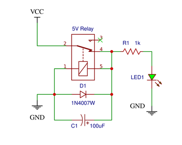

Step 2: Circuit Diagram
The circuit diagram is as shown above. The LED is connected between ground and normally closed terminal. A resistor is used in series with LED to limit the current flow through the LED. A 100uF capacitor is placed in parallel to the coil terminals to reduce the blinking frequency, basically slowing down the blinking so that we can observe it. The capacitor will also charge up when the supply is given and stores this charge. When supply is cut, it will start discharging through the inductor and thus keeping the current flowing through the coil for some time. This reduces the speed of changing the switch position. When the supply is cut and the capacitor has discharged, the coil which is an inductor will give out the stored current reversing the voltage polarity. The capacitor being electrolytic will also reverse his polarity and thus can burn out. To avoid this, we can place a diode anti-parallel to the capacitor which will take this current when the supply is cut. The negative of the capacitor and one terminal of the coil is connected to ground. The common terminal is connected to 5V supply. The remaining coil terminal is connected to the NC terminal.
This circuit works such that when you give the supply the LED turns on. The electromagnetic field also generates, moving the switch to NO position switching off the LED and the supply. Since the supply is cut, the switch returns back to the NC condition, turning on the LED and the supply. Thus in this case off time of the LED is more than the on time. If you connect the LED to the NO terminal, the on time will increase.

Turn on the supply to see the flashing. After running, the LED flashing was not visible, which means the flashing was taking place at a very high frequency which our eye cannot capture. Which means the capacitance value is not enough to slow down the LED, thus we added 220uF in parallel to this capacitor which slowed down the blinking, hence making it distinguishable. Thus, increasing the capacitance value will reduce the frequency. So you can use a capacitor value of 470uF for visible blinking.
