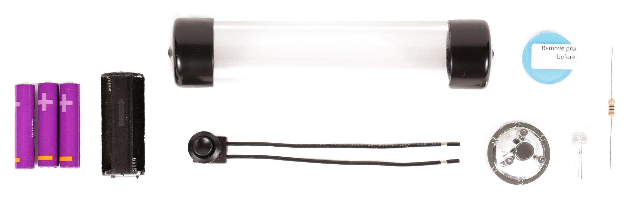

For this lesson you will need:
(x1) 1.25" x 6" mailing tube with end caps (or similar)
(x1) 8mm bright white LED
(x1) 10ohm / 1/2 Watt resistor (or appropriate for your LED and power supply)
(x1) LED reflector
(x1) 26.8mm flashlight lens (or similar)
(x1) Pushbutton toggle switch
(x1) 3 x AAA cylindrical battery holder
(x3) AAA batteries

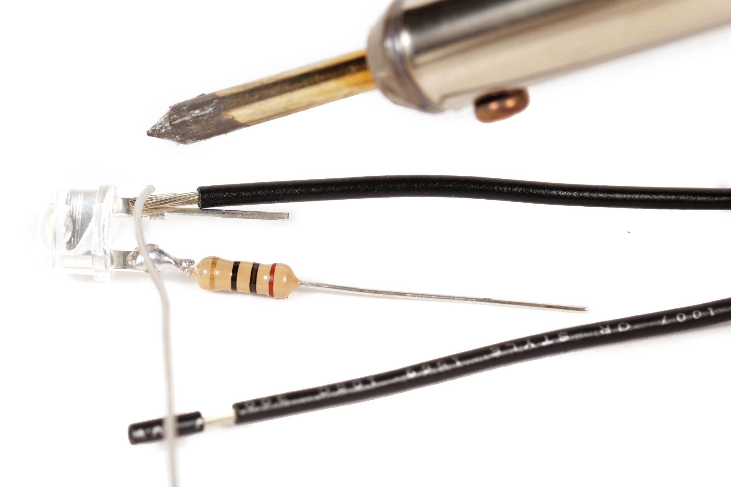

Solder the resistor the LED's anode (longer lead), and trim away the excess soldered leads from the joint.

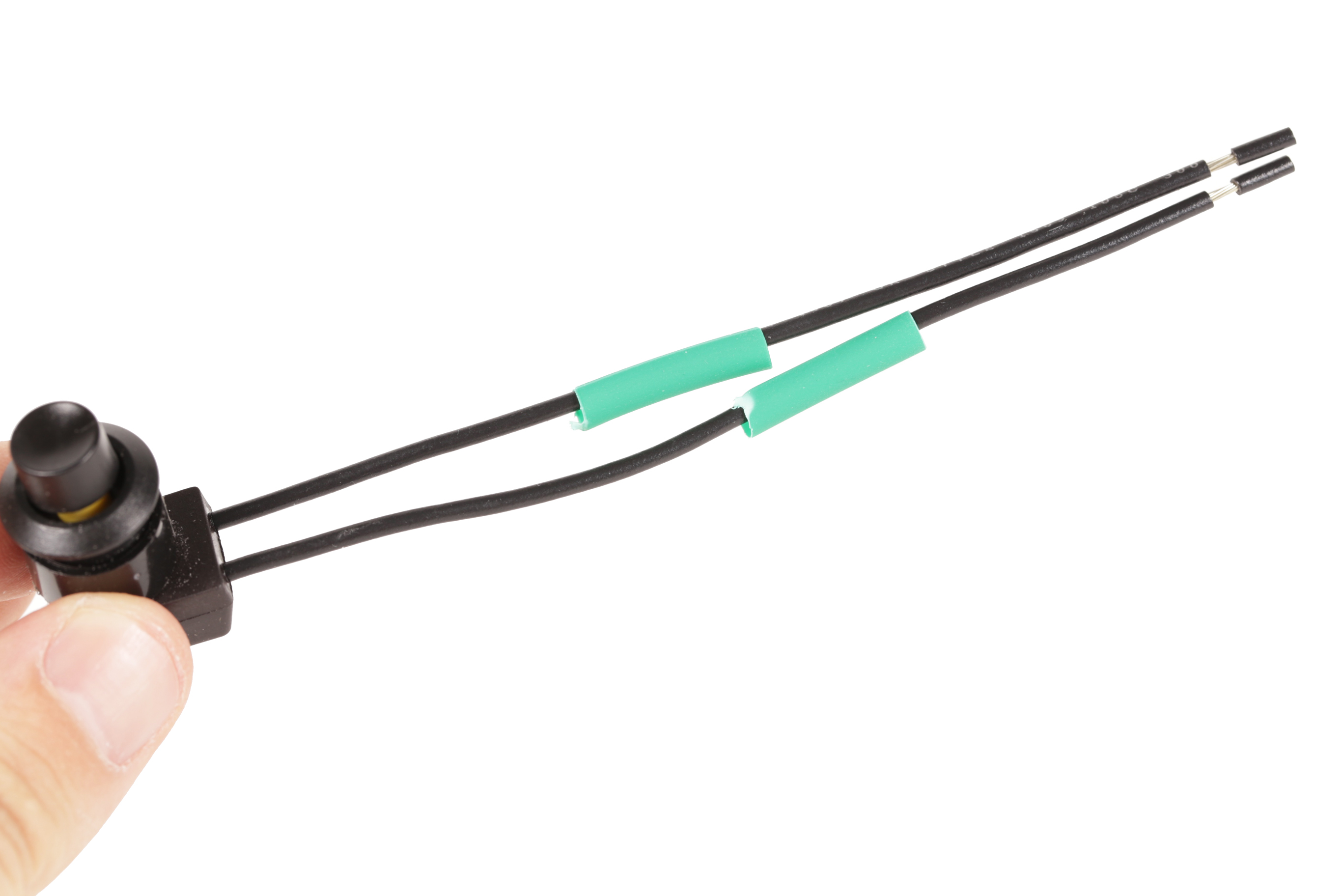

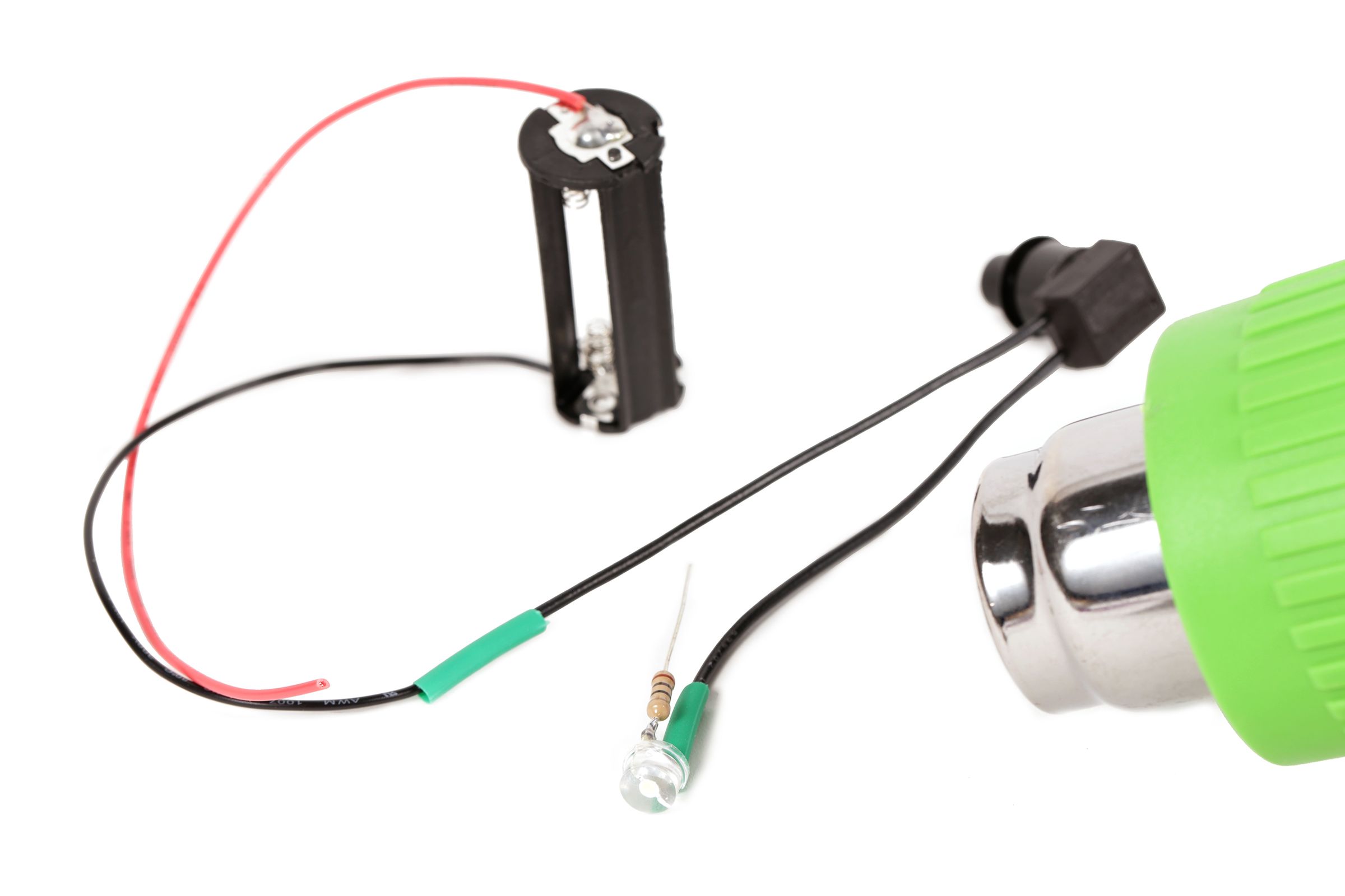

We will start by sliding a 1" piece of shrink tube onto each of the wires attached to the switch.

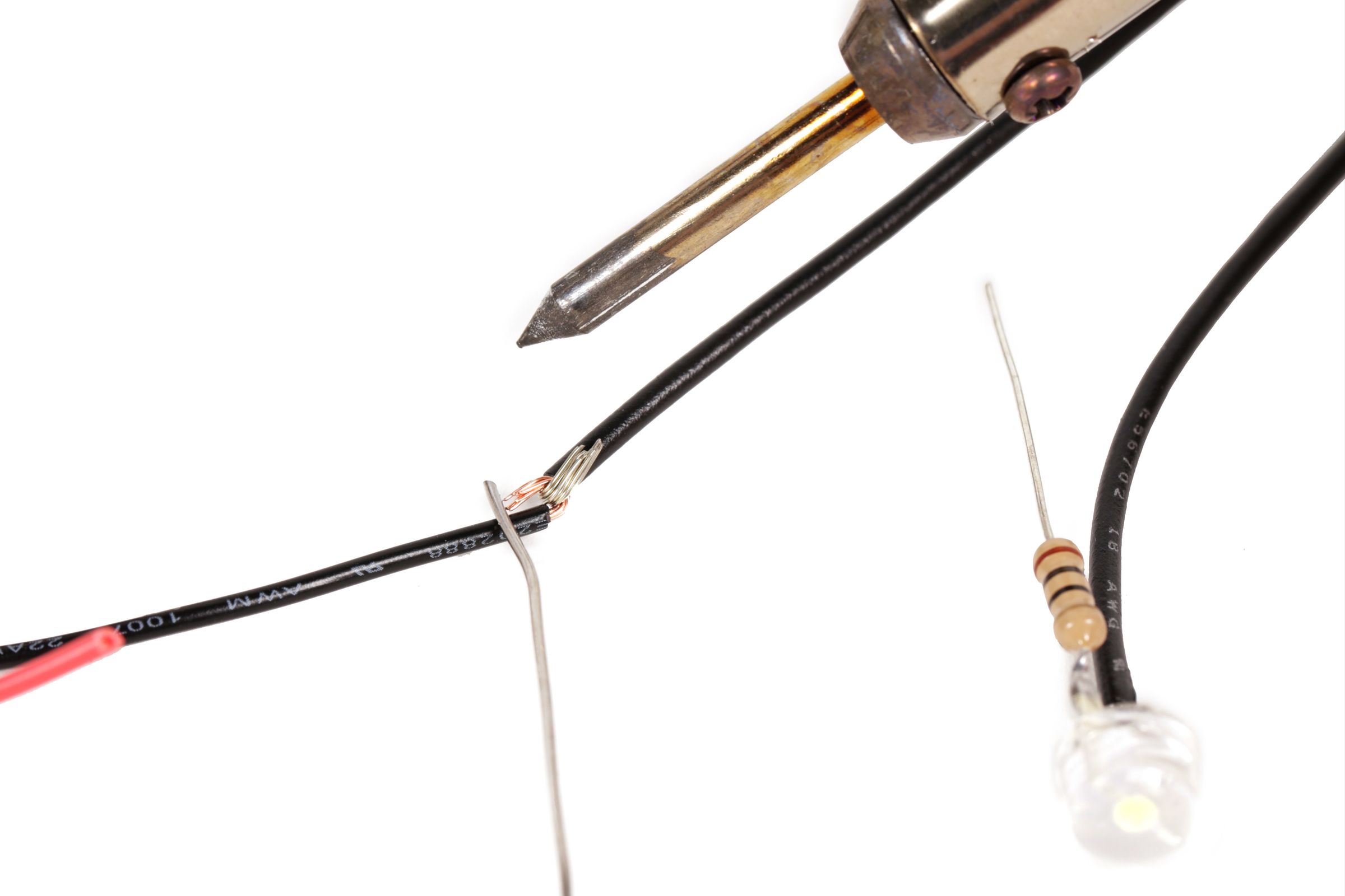

Once completed, solder one of the switch wires together with the black wire from the LED holder.
Then, solder the other wire from the switch to the cathode of the LED.
Insulate both joints with the shrink tube that had been slid on previously.

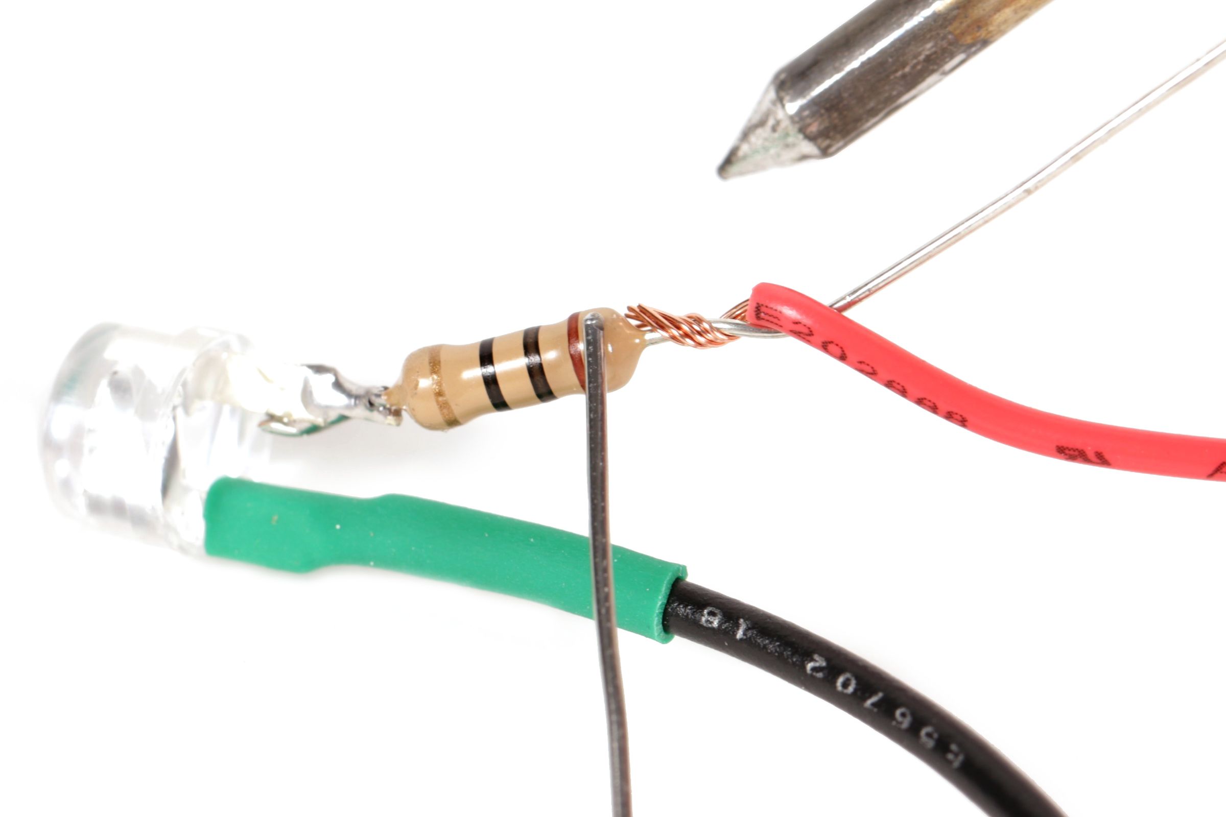

Finally, solder this red wire from the battery holder to the resistor's remaining lead.
