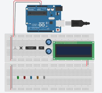

Step 1: Lay Out Components
Lay out your components on the breadboards, and example of a decent layout for this project is shown here in an image.

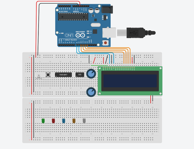

Step 3: Wire Up the LCD
Wire up the LCD in the same way as shown in the image provided, if it makes it easier you may also color code your wires. The LCD allows us to display the users score on in and tells them if they win when they reach 5 points.

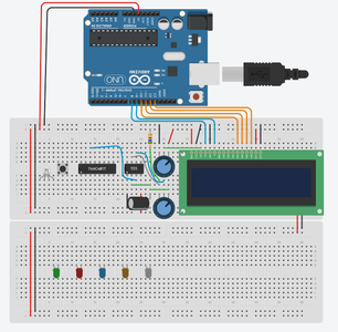

Step 4: 555 Timer
Attach the wires of the 555 timer as shown in the image, feel free to color code them to match the image provided. The 555 timer creates an oscillating wave that allows the lights to continuously move by sending pulses to the decade timer. The speed of the number of waves is controlled by its potentiometer.

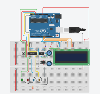

Step 5: Decade Counter and LEDs
Wire up the Decade Counter and LEDs as shown in the image provided, color code the wires if it makes it easier to match it to the image. The decade counter takes the wave from the 555 timer and sends that power to the 5 LEDs so that they count 1, 2, 3, 4, 5 not in random order.

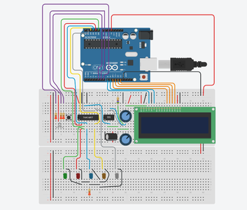

Step 6: RGB LED
Wire up the RGB LED in accordance with the picture shown, feel free to use the same color wires as the ones shown in the picture to make it easier. The RGB LED changes color randomly so that the user does not know which color is coming up next, to make the game more fun.

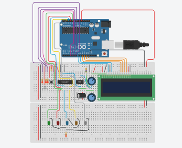

Step 7: Push Button
Wire up the push button as seen in the picture provided, use the same color wires if it makes the wiring easier for you. The purpose of the button is for the user to play the game, when they press it and both the LED lit and the RGB color match they get a point. This is wired directly into the arduino.
