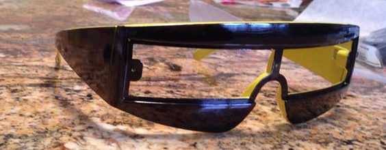

Step 1: The Glasses
This was, in my opinion, the trickiest part of the entire project, simply because it can be difficult to find a pair of glasses that have a wide enough bridge to allow an LED strip to pass over it. In my opinion, it's rather rare to come across exact same set of glasses that I used, which I found laying around my house.
Other options involve 3D printing a pair, or ordering a pair that are used with Cyclops (from the X-Men) costumes. Or using the popular shutter-shades glasses and trimming shutters to get it to the desired size.
In any case, for preparing the glasses for the strip, I screwed out the lens and painted the frame black. You're free to paint it any color you'd like. My reasoning was that when the wires went along the frame, I wanted them to blend into the color of the glasses so they would be less visible.
