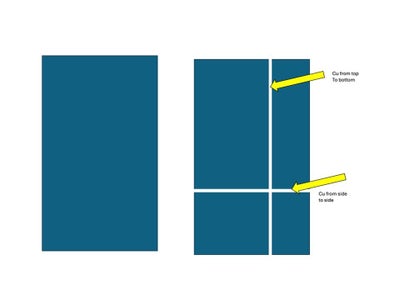

Step 1:
  1. cut 4x8 plywood to the desired desktop size
  2. make the 3 cuts for the marbles and lights for a total of 4 pieces

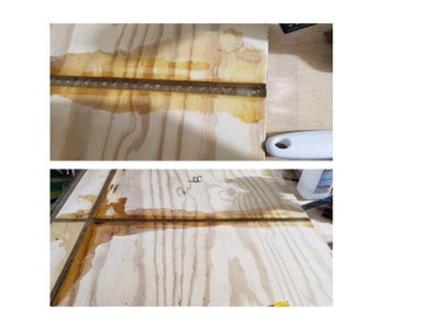

Step 3:
I suggest you tape up the edges or this is what it will look like. the prep work will save you time in sanding.

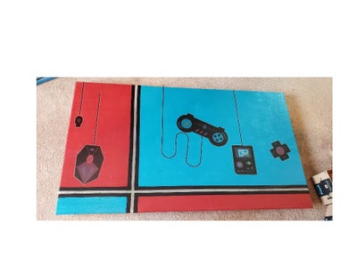

Step 5:
gather your supplies. I used sticker because it was quicker.
  1. run a strip of tape across the marbles so you don't get paint on them.
  2. use the primer over the entire surface.
  3. use your desired colors to pant the wood
  4. use the place electrical tape to out line the path of the marbles.
  5. use alcohol to clean any paint that you got on the marbles/resin

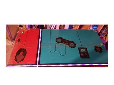

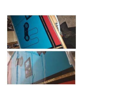

Step 6:
  1. pour a flood coat of epoxy over the entire table, use a heat gun to pop any bubbles.
  2. wait 4 days for the epoxy to harden enough before flipping the table top.
Step 7:
Add table legs
Step 8:
attach the light under the bottom of the table and along the edges of the wood and along the marble lines with the clamps.
