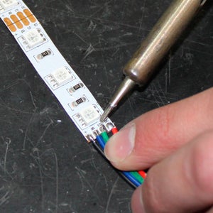

- Cut and peel back the protective coating on the strips
- Tin all the contacts on both sides
- Prepare several 1.5-2'' lengths of thin wire
- Solder the wires to the corresponding 12V, Red, Green, Blue contacts, wiring everything in series in a snaking pattern on the pan
- Use the double sided tape on the backs of the LED strips to secure it to the pan as you solder the wired on. Make sure your strips aren't shorted by contacts on the back from the aluminum pan. If this happens you can coat the back of the strips with tape.
- Make hole to feed the wires through so you can connect the LEDs to a controller!
