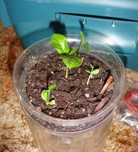

My planter utilized a Gatorade bottle because they make great self watering planters if you cut them just below the indented notch, which is a little above the middle of the bottle. I saw the idea first from whamodyne and will reference the instructable it's from:
https://www.instructables.com/id/Self-Watering-Plant-Container-out-of-a-2-liter-bot/
I used an old t-shirt that I cut into strips and used them to "wick" the water to my plant. The image below is fairly self explanatory. Since these will one day be lemon TREES, I can't keep them in there forever but for now it has been very useful in keeping my plants watered.
** It is helpful to wrap the container with something like old newspaper so that light is not shining on your water very much, to keep down the growth of algae. **

In my example, I am growing lemon, grapefruit and orange trees with my grow light, but you can probably do it to start any kind of plants you like!
