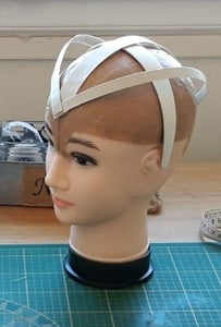

Prototype
The project has a fairly simple design but I still decided to built a prototype. It allowed me to see what the structure of the headpiece would look like. I was able to adjust where the headpiece will rest on my forehead and the length of the "wings" on the sides of the head.
Once I was satisfied with the shape of the headpiece, I measures the headpiece to calculate the length of the LED strip. For this project, I need a LED strip of approximately 1,40 m. This is a crucial information to select the type of LED strip you'll use.

Make PARTS B and C:
  • Heat B1 until it's soft and sticky.
  • Place B3 at the center of B1 and leave 2,5 mm on all sides (see 2nd picture).
  • Heat B2 until it's soft and sticky.
  • Place it on top of [B1+B3] and press on the sides to seal the borders close.
  • Reheat the PART B [B1+B2+B3] and place it on the headform while hot as shown on the 3rd picture. You can protect the headform with aluminium paper to avoid the Worbla to stick to it. Let PART B cool and harden in a half-circle shape.
Repeat for PART C.
