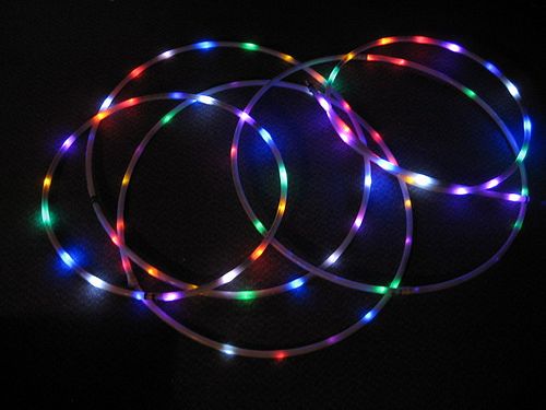

42 led's in 1 hoop. With the flick of a switch you can have 21 led's of one color scheme, then flick to the other and have 21 led's of another. All inside a 3/4 inch pipe for faster hooping styles.
I started learning about this because my GF wanted a LED hula hoop for christmas. After seeing sites online selling them for $250+ for rechargeable ones.. I decided i could make it myself. Thanks to the tutorial on here and prodmod for the inspiration.

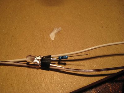

Resistors are basically used to drop the voltage so you don't fry the LED or draw more power then it needs.
Each LED requires a different voltage to light up. Some 2.4volts, some 3.6volts and so on.
Using OHM's Law, i calculated that with 4.8 Volts (4 x AA Rechargeable's). I needed 68 ohm resistors for the 3.6 V led's and 150 ohm resistors for the 2.4 and under LED's.
Some people use exactly 3.6 volts, lithium or 3 AA batteries. But as soon as the batteries start dieing they lose voltage and some LED's won't light up as bright or at all.
Here is theResistor Calculator Resistor Calculator. Pretty simple. Supply voltage is 4.8volts. Voltage Drop and Desired LED current is how much the LED needs. I will be posting how much each led needs on my site. And how many in the line.. so 21 or whatever.

Solder your resistors to your longer part of the LEDs.
And then solder the resistor to the positive wire.
Solder the other line of the led to the ground.
Tape up your exposed wires. And tape the wires together. Move on to the next led.
Always test the string before you move on to the next step. You can use a 9 volt battery to make it easier. Just touch the positive string to the small port and the negative to the pole with the folds.
