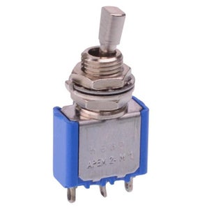

4) Electrical components.
A cable, a plug, a bulb and a switch. Only switch was new, everything else recycled. It's a miniature momentary toggle switch and I've paid a whooping £2.80 incl. delivery. It has a spring inside, so in order to change it's position you need to push it down and hold it. Once pressure is removed, internal spring will push it back to its neutral position. This "function" was crucial for my project, more about it later.

Step 4: Make a Switch
The thread size of the switch was identical to the threat size of the gate valve that I've used so that made my life easier. I've screwed it from the inside of the valve, and locked it from the back with locking nut in a position where the lever sits under the valves gate. Switch has three terminals, and can be configured as push to make or push to brake. I've set it up in a similar way as those valves are used to stop or restrict the flow of fluids, so in my case it's a "push to break" configuration. When you close the valve by rotating the knob clockwise, the gate inside will go down pushing the lever. This will break the circuit and the light will go off. If you mimic opening the valve to let eg. water to go through this will move the gate upwards, and the spring within the switch will activate the LED bulb.
