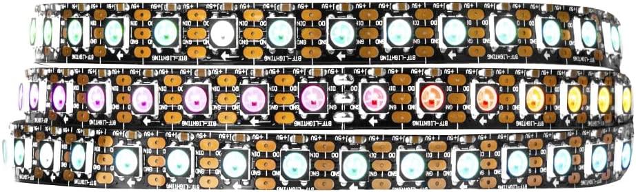

  • Strip led BTF-LIGHTING 3.2FT 1m WS2812B 100 Pixeles.

Step 1: Configuring NeoPixels
The first thing to do is to check and configure the LED strip. For the configuration of the LED strip we use the NeoPixels library. You can find the library here::
https://github.com/adafruit/Adafruit_NeoPixel
In our case, we have configured the LED strip for 100 LEDs.

  • The LED strip has 5 wires to connect, the three that are together which are red, black and green, which represent Vcc, Gnd and Signal, plus two reinforcement wires of Vcc and Gnd. So at first we only have to connect the Gnd and Signal which will go to the board, to the Signal we will assign an output pin. To feed the strip we will use those of reinforcement, but these instead of going to the board will go to the input of the relay, as if it were a circuit aparate, so that when the relay is activated it works and when not, it turns off independent mind of the values of the other sensors or of the signal that it sends to the strip led.
