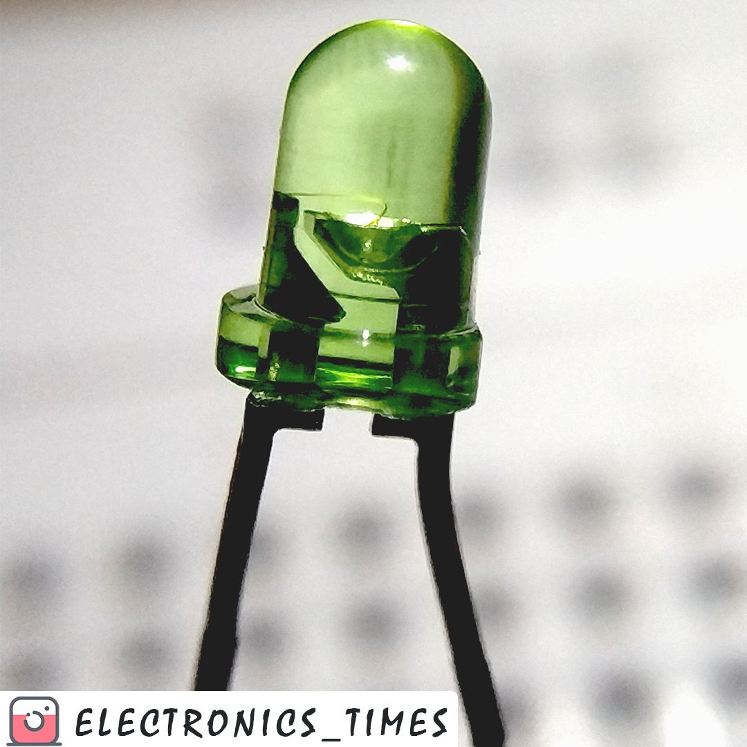

Step 2: Connection:
All the LED Connected in Source Modeand in Common Cathode Modewith the Protection Resister of 330ohm.
Please refer link for the Mode Diagram.
