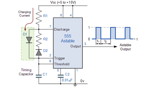

This circuit is a very common favourite of all electronics geeks. The schematic for the circuit can be seen in the first image. Here is a link to the website where I got the circuit image from https://www.electronics-tutorials.ws/waveforms/555...

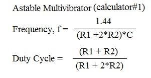

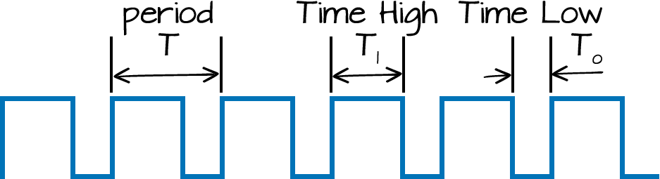

For this project, the circuit is wired up in an astable configuration. This means that the voltage output of the chip alternates between high and low at a constant frequency. The voltage output vs time graph of this circuit can be also seen in the image.
It is a square wave. Essentially the circuit produces pulses at a constant rate. This can be used to make an LED blink. The frequency of the pulse can be controlled used the values of the two resistors and the capacitor. These are respectively R1, R2, and C1 in the image. The equation used to calculate the frequency from these values has been given in the equation.
The final term is the duty cycle. It is the percentage of time for which the output is high. This can be also calculated with the equation in the image. Unfortunately, if the duty cycle is too high it leads to bouncing (link) or the connecting circuit can't even detect the pulse/low period.
To rectify this issue, this circuit has an additional 2 diodes compared to the conventional circuit. This is to make the duty cycle more even 50%-50% between on and off. (link)

The pin number refers to the pin number of the 555 IC. It is numbered in a U shape starting from the top left and ending at the top right.
Pin 1 Connections: Connected to Ground directly.
Pin 2 Connections: Connected to pin 6 directly, connected to R2 through D1
Pin 3: It is the output. Connected to the clock pin (pin 14) of the 4017 IC directly.
Pin 4 Connections: Connected to Vcc directly.
Pin 5 Connection: Not connected to anything.
Pin 6 Connections: Connected to Pin 2 directly.
Pin 7 Connections: Connected to Vcc through R2, to pin 6 through D1.
Pin 8 Connections: Connected to Vcc directly.
There are a couple of points to note that have helped me identify issues with my circuit.
It is crucial to connect pin 4 and 8 to the Vss in parallel and not series. Each pin should be individually connected to the positive rail.
I have found it easier to leave pin 5 alone with noconnections. It reduces one component from the BOM while still working properly.

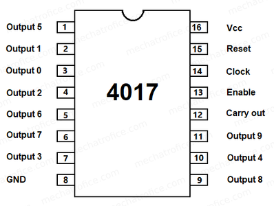

Pin 1-7 + pin 9-11: These are all the output pins to which the LEDs will be connected to in order.
Pin 8: Connected to ground directly
Pin 12: Is not connected to anything
Pin 13: Connected to ground directly
Pin 14: Connected to pin 3 lead of the 555 timer circuit directly
Pin 15: Connected to ground directly
Pin 16: Connected to the positive rail (Vss) directly.

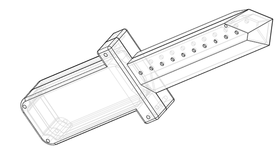

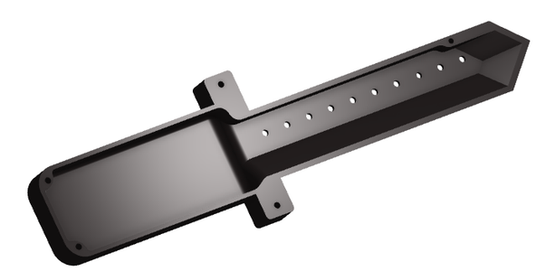

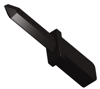

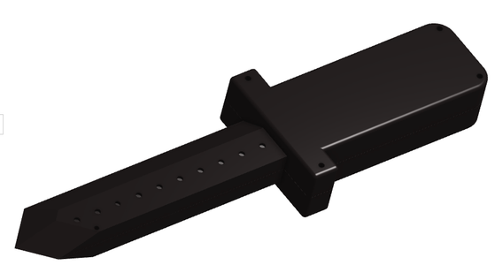

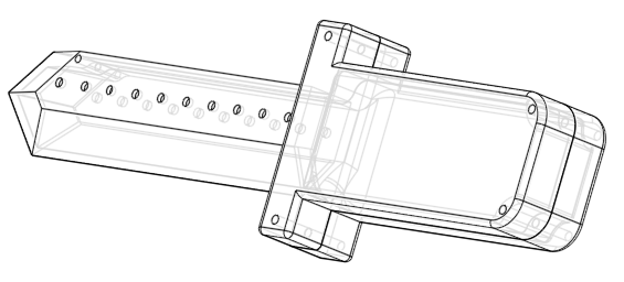

Step 22: Designing the Knives for the Circuitry Housing
I used Onshape to design the knives. It is free I believe. Here is the link: https://www.onshape.com/en/
Points to note about the design:
- Each knife is comprised of two halves, secured together using bolts.
- The circuitry fits into the compartment in the hollow handle.
- The leads coming out of the 4017IC is held in the hollow section of the blade.
- The LEDs fit into the holes on the blade and here the leads from the circuit are connected to the LEDs.
- There are 4 holes on the handle, which are for the screws, that hold the two halves together.
- There is also 1 hole on the blade near the blade's tip, which is for another screw that helps hold the blade ends together.
- The total dimensions of a single half of a knife are 261mm long x 71mm wide x 15mm thick

The maleoutput leads from the circuits are plugged into the femaleconnectors.
To understand the sequence of connection, follow the attached image of the 4017IC's pinout.
You would start with pin 3, which denotes output number 0, and connect it to the LEDs closest to the handle. Following that sequence, you will have pin 4 (output number 1), pin 2 (output number 2) so on and so forth.
You can find the sequence here:
1) Pin 3
2) Pin 4
3) Pin 2
4) Pin 7
5) Pin 10
6) Pin 1
7) Pin 6
8) Pin 7
9) Pin 9
10) Pin 11
Additionally, you will also have to connect the negative rail lead, soldered back in step 21, to the common cathode female connector.
