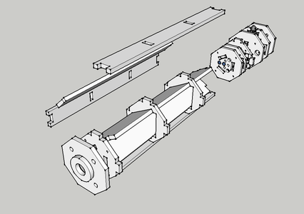

As always, I'm starting my project Virtuel. This helps me to make sure that everything fits together right from the start. Reality will show whether it really works.
For the 3D design I still use the good old Google Sketchup 8. To create the DXF file I use Qcad. This file is then processed in Inkskape so that my laser cutter understands it.

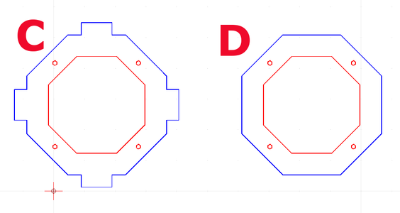

Unfortunately I forgot to take pictures of parts C and D, so I only have the 2D drawing. These are glued to part no. 1 as shown in the photo, with part C with the brackets all the way out.

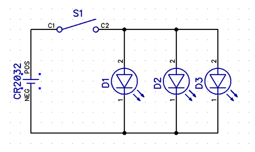

A CR2032 can handle up to 3 LEDs. I sanded down the front side. now they are less bright and more diffuse.
Now you can install the flashing, colour-changing or flickering LEDs. There is space for 3mm or 5mm LEDs. However, a maximum of 3 can be connected in parallel. These LEDs are designed for 3 volts, so the CR2032 is perfect. In my photo you can see more bulbs, but they are not all wired. As this is my prototype, I am testing different combinations.
The micro switch and the CR2032 battery are installed as shown in the photo. The plus pole of the battery is at the bottom.Then solder the wires to the two copper foils. Red is plus, blue is minus. The switch is simply connected in series.
Now just solder the LED's and assemble the whole thing with 20mm M2.5 screws.
