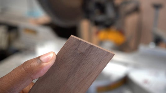

As mentioned, the lamp head is Walnut. See the materials list of digram below for measurements. I wanted the lamp to have a bit of a lean-to it, so I cut a 15deg miter on one end at the miter saw.

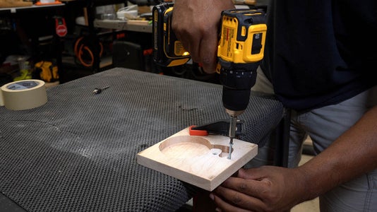

Step 3: Drill a Hole to Pass the Light Power Wire
Find the center of the lamp base, drill a ¼in to 3/8in hole for the wire to pass through both the lamp head and the base. What worked out well was drilling from the bottom right through the center. Then drill another hole from the LED channel down and angled towards the hole drilled previously.

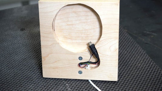

Step 4: Route the Lamp Base for the Wireless Charger
This part is the more time communing part of the project. Not just the routing but trying to make it work. When using the router, make sure you are keeping track of the thickness of the lumber, the thickness of the wireless charger, and how much material you are removing. It all depending on the Wireless charger you are using, and there is a lot out there. This one is used “ Blitzwolf ” around $8 each and it works, but there are a number of them to try out “ click here ”
If you want to keep the base as thin as possible, then you need to find one close to the thickness of .43in thick. Otherwise, you may be to add depth to the base. The one I used work great, but because I use an otter box case on my phone, it was hit and miss through the wood and the case. It worked flawlessly with no case on the phone.

Step 8: Installing the Wireless Charger
Now plug the Mirco cable in the wireless charger, then hot glue it into the base. If you have slack on the wires you can coil them up in the base. I didn't talk much of the bottom cover. The piece I used is a 1/8in thick. You can probably get by without it. It adds a solid layer to the bottom and more surface for the felts pad.
