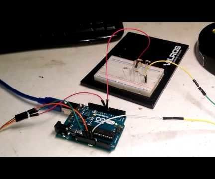

Step 2: Putting It Together
Connect the components as shown in the picture or as written below:
- GND on raspberry pi <> GND on relay
- 5v on raspberry pi <> VCC on relay
- GPIO13 on raspberry pi <> IN1 on relay
- COM on relay <> 1 hotwire from 120VAC
- NO or NC on relay <> 1 wire from lamp
- Other hotwire from 120VAC <> other wire from lamp
