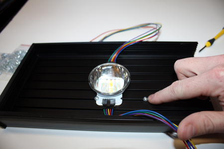

Step 3: Install the Screws and Nuts Into the Appropriate Heatsink T-Slot
The t-Slots allow the flexibility to change the LED fixture at any point.
Step 4: Slide 4 Screws+nuts Up to the 70W LED Module and Tighten Them Snugly to Create a Solid Thermal Connection to the Heatsink.
Step 5: Install Wires on Lumia 5.2 LED Module W/ Cable Harness
Note the (+) and (-) terminals on the Lumia 5.2 LED Module. Install the cables such that the blue wire ends are negative and the red wire ends are positive. Slide the MakersDRIVER into the Fixture.

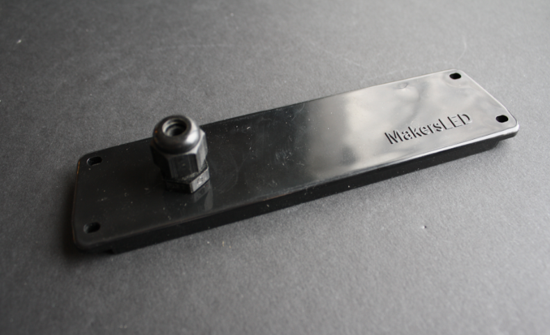

Step 6: Prepare the 2 Pin (2 Conductor) 1/2" Endcap Connector
OPTIONAL: A cord connector/cable gland would also work if you prefer not to solder)
This connector is where the 48V power will enter into the LED fixture and power the MakersDRIVER LED Driver.
Solder a short 18 gauge wire onto the panel mount side of the connector, then an 8ft wire segment to the outer connector to connect to the power supply. Each pin on this connector is labeled: "1" and "2" - on both the panel mount side and the wire mount side. Be sure to follow these labels (ie, use Red Positive= 1 and Black Negative =2) when soldering both connectors. If you do not, and cross pins, you will have a short!
