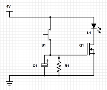

The circuit is a very simple RC timer (see e.g. here, here, or here), using a MOSFET (Q1) as a switch. MOSFETs start conducting when the gate-to-source voltage (between the lower two pins) becomes more than a threshold, which for the IRF3708 is between 0.5 and 2 volts. Above this threshold the resistance from drain to source (the rightmost two pins) is very low, in the milliohms. If the gate-to-source voltage is lower than 0.5, then the MOSFET blocks all current, with essentially infinite resistance.
The circuit functions as follows. When the button S1 is pressed, the capacitor is charged to 4V; then the gate of MOSFET Q1 is at 4V, and the MOSFET is completely open, with very low resistance, and the LED D1 sees the full voltage drop of 4V; the lamp is on.
When S1 is released, the capacitor starts to discharge through resistor R1, and the voltage at the gate of Q1 slowly decreases. Somewhere around 2 volts the MOSFET starts to close, decreasing the voltage drop over the LED D1. When the voltage drop over D1 has decreased from 4V to around 3.3V the LED no longer conducts, and the light goes out. After that the capacitor continues to slowly discharge itself.

To be honest, I determined the values of the capacitor and the resistor by trial-and-error. A quick calculation (see below) told me that I needed both values to be rather large; I took the largest resistor I had and played around with different large capacitors. I was looking for 20-30 minutes timer time without the circuit becoming too bulky. Some of the capacitors with higher capacitance are really bulky, and then the circuit wouldn't fit in the container.
You can get a rough estimate from calculating the `RC constant' (see Wikipedia for more information). Multiply the resistance with the capacitance: in our case 470 muF times 4.5 MOhm, or in scientific notation 470E-6 F times 4.5E6 Ohm, which is 2115 FOhm. Farad times Ohm is seconds, so this gives a time of about two thousand seconds, or 36 minutes. This is the time over which the capacitor's charge reduces by a factor 2.7, so from 4V to about 1.5V. In fact the LED turns off a little earlier than that, since the threshold voltage of the MOSFET is closer to two volts. Hence the twenty minutes time span, roughly.
