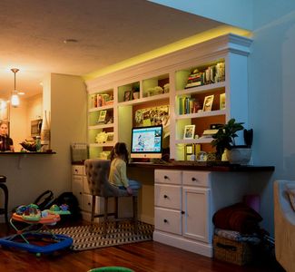

About a year ago (fall 2015) I was looking to upgrade my home computer. I have been doing a lot of photography and some home video editing and I really needed an upgrade, and then it daunt on me. I have no workspace to place a computer on. Furthermore, I realized that I have an pretty open floor plan and no real counter space to put the mail and I could really use some additional storage. Most of the time, my mail tended to clutter the corner of my kitchen counters. That is when the plan was created to build a new bookcase.
This intructable covers my thought process into how this project was designed and executed. I write all of this in retrospect, so this won't be a complete step by step tutorial. But since this bookcase was highly customized to the space available to me, I assume the objective here is to create ideas and give pointers on how to build an LED lit bookcase for any situation. In fact, if I had to do it again I would do a few things different. I actually list a summary of those "lessons learned" in the final section of this intractable.

I started making a rough sketch of the bookcase. Here is where a couple of big decisions need to be made. For instance, the hight of the countertop needs to be specified. I chose to have a higher desk space so I could work while standing (I sit enough at work). This allowed for the use of regular kitchen base cabinets to be use. I also space out a few butcher blocks to be used as countertops. It became clear early on that butcher block of the size I wanted where either not available or had to be custom made at a high price. Bobbie, my father in law promised me he could make one from base materials. I decided that I did not want the crown moulding to reach the ceiling but rather leave a 5 in. gap that could be lit up.
