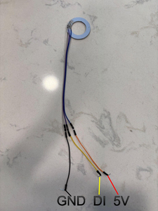

Step 1: Wiring
Please refer to pictures for assistance.
  1. Place the Pi Pico on one end of the Breadboard.
  2. Place the Breadboard Power Supply on the other end.
  3. Insert a Jumper Wire into the - rail of the Breadboard to the GND pin of the Pi Pico.
  4. Insert Wires into the 5V, DI, and GND pins of the Neopixel ring
  5. Insert the 5V wire into the + rail of the Breadboard
  6. Insert the GND wire into the - rail of the Breadboard
  7. Insert a 300-500 ohm resistor from GP16 of the Pi Pico to a pin in the empty section of breadboard, trimming excess wire.
  8. Insert the DI wire into the same row as the resistor.
  9. insert a wire from the VSYS to the + power rail on the Breadboard.
  10. Plug the Breadboard power supply cable into the Power Supply and Micro-USB cable into the Pi Pico
