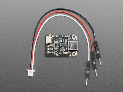

Step 3: Programming
This project is a good example of a bare chip that is powerful and easy to program.
This blank chip can be programmed using a UPDI programmer in the Arduino IDE environment. Follow the excellent steps provided by Adafruit.
On the back of this board, there are three pads: Vin, Gnd, and UPDI programmer. I solder three separate male headers onto these pads. I use clay to help align the headers when I solder. Look at the pics above (differnet board but same process). Soldering and Assembly step below for more detailed build instructions.
Programming
Follow the directions from Adafruit, but I will summarize:
- In Arduino, add the following URL to your Boards Manager preferences: http://drazzy.com/package_drazzy.com_index.json
- Install megaTinyCore from the Boards Manager.
- Under Tools, select:
- Board: megaTinyCore: ATtiny1616
- Chip: ATtiny1616
- Clock: 10 MHz
- Programmer: SerialUPDI - SLOW: 57600 baud
- Finally, go to Sketch > Upload Using Programmer. Upload a blank sketch to confirm it works.
You should see your UPDI friend blinking and the code being successfully uploaded to the board. If it doesn’t upload, the most likely culprit is that the chip wasn’t soldered properly. Soldering tips below.
