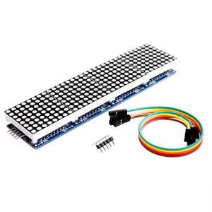

  • LED MATRIX. We are going to use the FC-16 module which has four casacaded 8×8 LED Matrix Displays and a built-in MAX7219 LED Driver for each display.

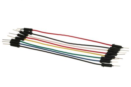

  • Jumper wires

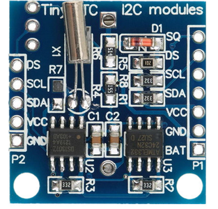

  • RTC DS1307 module

  • Connect RTC DS1307 module pin[VCC] to Arduino pin[5V]
  • Connect RTC DS1307 module pin[GND] to Arduino pin[GND]
  • Connect RTC DS1307 module pin[SDA] to Arduino pin[SDA]
  • Connect RTC DS1307 module pin[SCL] to Arduino pin[SCL]

  • Connect LED Matrix pin[VCC] to Arduino pin[5V]
  • Connect LED Matrix pin[GND] to Arduino pin[GND]
  • Connect LED Matrix pin[DIN] to Arduino digital pin[11]
  • Connect LED Matrix pin[CS] to Arduino digital pin[10]
  • Connect LED Matrix pin[CLK] to Arduino digital pin[13]

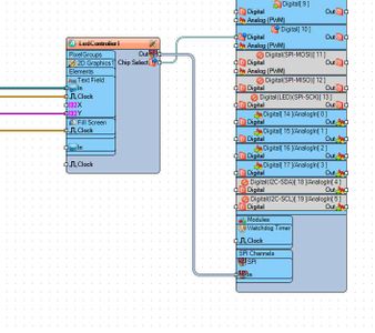

Step 3: Start Visuino, and Select the Arduino UNO Board Type
The Visuino: https://www.visuino.eu also needs to be installed. Download Free version or register for a Free Trial.

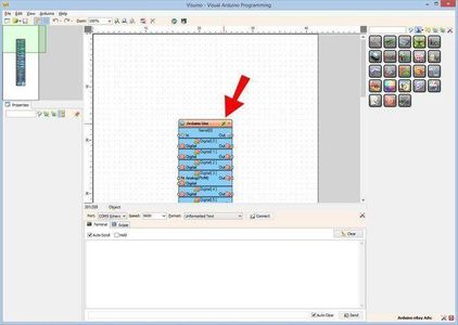

Start Visuino as shown in the first picture Click on the "Tools" button on the Arduino component (Picture 1) in Visuino When the dialog appears, select "Arduino UNO" as shown on Picture 2

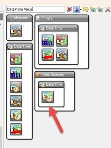

  • Add "Date/Time Value" component

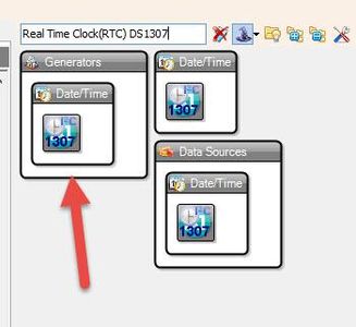

  • Add "Real Time Clock(RTC) DS1307" component

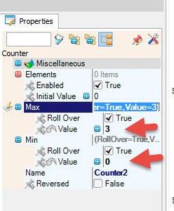

  • Select "Counter2" and in the properties window set Max>Value to 3
  • Select "Counter2" and in the properties window set Min>Value to 0

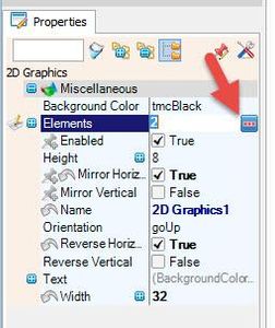

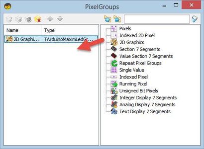

  • Double click on the "LedController1" and in the "Pixel Groups" window drag "2D Graphics" to the left side
  • and in the properties window set "Mirror Horizontal" to True and "Reverse Horizontal" to True and set "Width" to 32

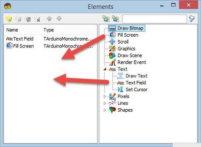

  • also select "Elements" in the properties window and click on the 3 dots button
In the Elements window drag:

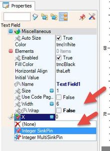

  • "Text Field" to the left side and in the properties window set "Wrap" to False, and click on the "X" pin button and select "Integer Sink Pin" and click on the "Y" pin button and select "Integer Sink Pin"
  • "Fill Screen" to the left side
Close the "Elements" Window

  • Select "DateTimeValue1" and in the properties window set "Value" to your current date and time

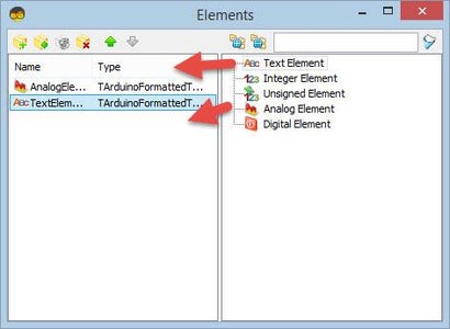

  • Double click on the "FormattedText1" and in the Elements Window
  1. drag "Analog Element" to the left side and in the properties window set "Precision" to 1
  2. drag "Text Element" to the left side and in the properties window set "Initial Value" to C
Close the Elements Window

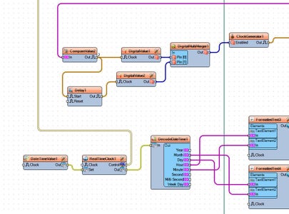

Step 6: In Visuino Connect Components

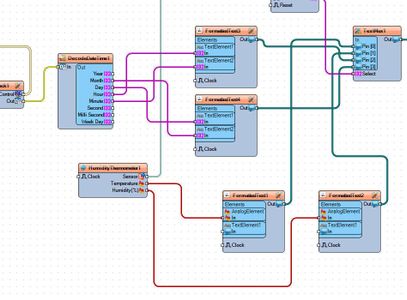

  • Connect "DateTimeValue1" pin Out to "RealTimeClock1" pin Set
  • Connect "RealTimeClock1' pin Control I2C to Arduino pin I2C In
  • Connect "RealTimeClock1' pin Out to "DecodeDateTime1" pin In
  • Connect "DecodeDateTime1" pin "Month" to "FormattedText4 > "TextElement2" pin In
  • Connect "DecodeDateTime1" pin "Day" to "FormattedText4 > "TextElement1" pin In
  • Connect "DecodeDateTime1" pin "Hour" to "FormattedText3 > "TextElement1" pin In
  • Connect "DecodeDateTime1" pin "Minute" to "FormattedText3 > "TextElement2" pin In
  • Connect "HumidityThermometer1" pin Sensor to Arduino Board Digital pin [4]
  • Connect "HumidityThermometer1" pin Temperature to "FormattedText1>AnalogElement1" pin In
  • Connect "HumidityThermometer1" pin Humidity to "FormattedText2>AnalogElement1" pin In
  • Connect "FormattedText1" pin Out to "TextMux1" Pin[0]
  • Connect "FormattedText2" pin Out to "TextMux1" Pin[1]
  • Connect "FormattedText3" pin Out to "TextMux1" Pin[2]
  • Connect "FormattedText4" pin Out to "TextMux1" Pin[3]
  • Connect "TextMux1" Pin Out to "LedController1 > Text Field" Pin In
  • Connect "CompareValue2" Pin Out to "Delay1" Pin "Start" and "DigitalValue1" Pin Clock
  • Connect "Delay1" Pin Out to "DigitalValue2" Pin Clock
  • Connect "DigitalValue1" Pin Out to "DigitalMultiMerger1" Pin [0]
  • Connect "DigitalValue2" Pin Out to "DigitalMultiMerger1" Pin [1]
  • Connect "DigitalMultiMerger1" pin Out to "ClockGenerator1" Pin "Enabled"

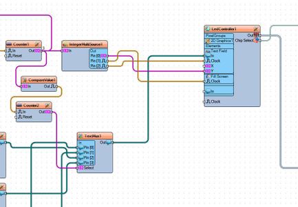

  • Connect "ClockGenerator1" pin Clock to "Counter1" Pin In
  • Connect "Counter1" pin Out to "IntegerMultiSource1" pin In, and "CompareValue1" pin In and "CompareValue2" pin In
  • Connect "CompareValue1" pin Out to "Counter2" Pin In
  • Connect "Counter2" pin Out to "TextMux1" pin Select
  • Connect "IntegerMultiSource1" pin [0] to "LedController1 > Text Field" Pin Y
  • Connect "IntegerMultiSource1" pin [1] to "LedController1 > Fill Screen" Pin Clock
  • Connect "IntegerMultiSource1" pin [2] to "LedController1 > Text Field" Pin Clock
  • Connect "LedController1" Pin Out SPI to Arduino Board pin SPI In
  • Connect "LedController1" Pin Chip Select to Arduino Board Digital pin [10]
