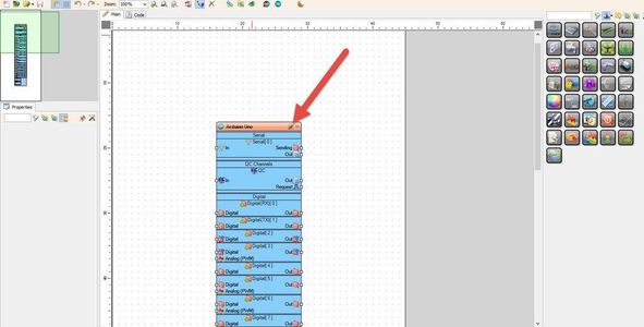

Step 3: Start Visuino, and Select the Arduino Board Type
Start Visuino as shown in the first picture Click on the "Tools" button on the Arduino component (Picture 1) in Visuino When the dialog appears, select "Arduino UNO" as shown on Picture 2 or any other board.

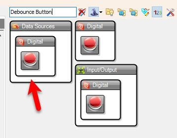

Step 4: In Visuino Add Components
  • Add "Debounce Button" component

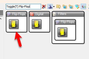

  • Add "Toggle(T) Flip-Flop" component

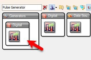

  • Add "Pulse Generator" component
  • Add "Up/Down Counter" component
  • Add "Digital Multi Source" component
  • Add "Integer Multi Source" component

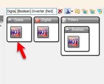

  • Add "Digital (Boolean) Inverter (Not)" component
  • Add "Maxim LED Display Controller SPI MAX7219/MAX7221" component

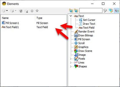

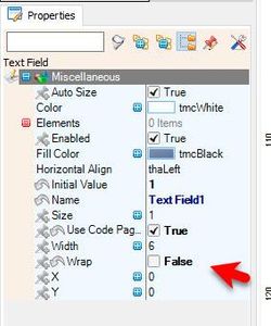

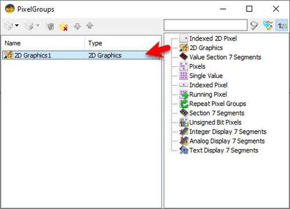

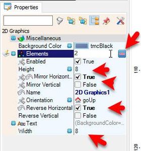

  • Double click on the "LedController1" and in the "Pixel Groups" window drag "2D Graphics" to the left side
  • and in the properties window set "Mirror Horizontal" to True and "Reverse Horizontal" to True and set "Width" to 8 and "Height" to 8
  • also select "Elements" in the properties window and click on the 3 dots button
In the Elements window drag:
  • "Fill Screen" to the left side
  • "Text Field" to the left side and in the properties window set "Wrap" to False
  • Close the "Elements" Window

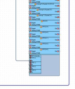

  • Connect "LedController1" Pin Out SPI to Arduino Board pin SPI In
  • Connect "LedController1" Pin Chip Select to Arduino Board Digital pin [10]

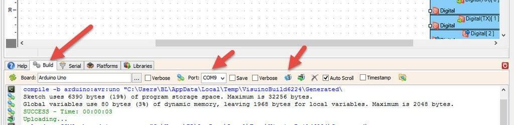

Step 7: Generate, Compile, and Upload the Arduino Code
In Visuino, at the bottom click on the "Build" Tab, make sure the correct port is selected, then click on the "Compile/Build and Upload" button.
