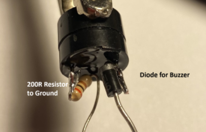

Apologies for my circuit diagram. Learning KiCad is on my list. The intention of the diode on the buzzer is to prevent any transient voltage from getting to the pin from the buzzer pathway as a 'button press' when the pinMode is INPUT. It may not be necessary. I was being conservative. It works fine so far.

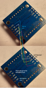

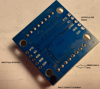

In order to try to organize the wiring in the tight space, my circuit has the displays oriented with Row 7, Column 7 at the BOTTOM for each matrix. The sketch is written to account for this orientation of the matrices.
To orient the matrices (7,7) at the bottom, place your display LEDs DOWN on the table and with the '1088AS' text on the BOTTOM RIGHT in the diamond orientation, (7,7) will be at the bottom) and the IN-side connection of the display will be on the BOTTOM LEFT of the diamond orientation.
It's recommened you solder the two displays together as shown in the second picture, then solder short jumper wires to the lower left side of the bottom display. Then you can test the display on a breadboard before returning to build the whole circuit on prototype board.

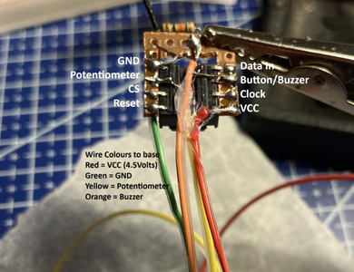

One design challenge of using the ATTiny85 was that I was short one pin for the buzzer. I could have used Pin 1 (RST) if I used a separate chip programmer to change fuses. I didn't have a second appropriate programmer.
My solution uses Pin 6 (GPIO1) for both the Start/Stop button AND the buzzer. When the hourglass is counting down, the pin is an INPUT pin. Every time it's pressed during countdown, the sketch switches GPIO1 to an OUTPUT mode and plays a short beep through the buzzer.Then it switches back to INPUT mode so the button works.
When the countdown expires, the sketch switches the GPIO1's mode back to OUTPUT, plays the ending tones and then switches back to INPUT so the button is ready for the next countdown.
The diode manages the direction of current flow based on the mode of the pin, button versus buzzer.
I wired the RST pin through a pushbutton to GND so that you may reset the whole hourglass as needed. it's preferable to switching it OFF/ON.

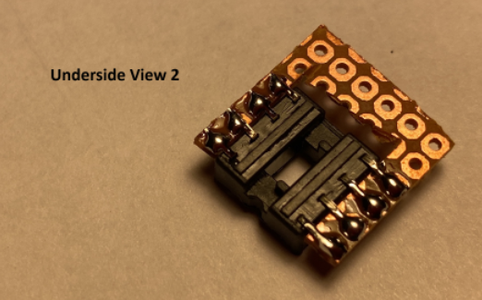

To minimize the height of the circuit and ATTiny85, the 8 pin socket was recessed into the prototype board rather than through-hole mounted. This saves about 2mm of thickness.This takes some careful cutting with the Dremel Tool. Since the prototype board is very thin and brittle, if you're going to do this, it's recommended you cut out the recess for the socket, SOLDER IN THE SOCKET and then cut the rest of the board to size. The soldered socket will give strength to the rest of the board as you do the rest of the cuts. It's perfectly fine to through-hole mount the socket if you prefer.

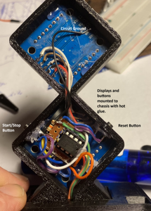

  3. Solder/wire the OUTPUT connections of the BOTTOM display to the INPUT connections of the top display.
  4. Solder short length wires(~40mm) to the connections on the BOTTOM display.
  5. Cut your prototype board to size and solder on the components as per the photos. It's going to be a tight fit.

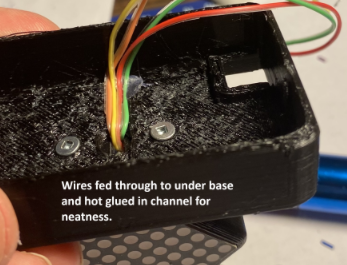

  6. For your potentiometer (A2), buzzer (GPIO1), VCC and GND, use wires about 80mm long that you can feed through the hole in the base when finishing wiring.
  7. Feed the displays into place from the back of the enclosure, routing the wires joining the display through the channel in the middle of the enclosure.
  8. Solder your circuit board to the 5 wires coming from the bottom of the display as per the circuit diagram.
  9. Feed the potentiometer, buzzer, VCC and GND wires down through the hole in the base. Solder them to the potentiometer, buzzer and switch as per the diagram.You'll see I soldered the 200 Ohm resistor to the positive size of the buzzer rather than on the circuit board. Do whichever way works for you.
