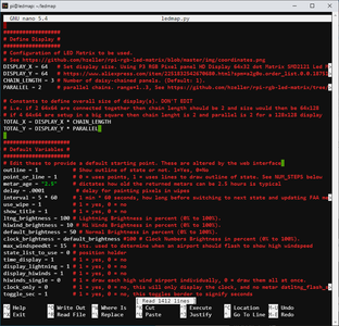

Configure the Display Size
From the command line enter;
cd ledmap
sudo nano ledmap.py
Scroll down to the section labeled 'Define Display' and change the values listed there. For a single 64x32 Matrix display you would fill it out this way.
DISPLAY_X = 64
DISPLAY_Y = 32
CHAIN_LENGTH = 1
PARALLEL = 1
For a multiple Matrix Display using 2 rows and 3 columns of 64x64 Matrix displays it would be filled out like this;

For those who would like more flexibility there are a number of constants stored in 'ledmap.py' that can be altered. Below is a list of some that might be desireable to play with.
NUM_STEPS = 1     # Adjust the resolution of the outline of the state. 1 is best, but slowest
There are alot of lat/lons in the data files and the speed at which they are processed can be sped up a bit by skipping some. So increasing this number will speed things up but won't draw the outline as accurately.
RED = (255, 0, 0)       # used to denote IFR flight category
GREEN = (0, 200, 0) # used to denote VFR flight category
BLUE = (0, 0, 255) # used to denote MVFR flight category
MAGENTA = (255, 0, 255) # used to denote LIFR flight category
WHITE = (255, 255, 255) # used to denote No WX flight category
YELLOW = (255,255,0) # used to denote Lightning in vicinity of airport
BLACK = (0, 0, 0) # Used to clear display to black
GREY = (50, 50, 50) # Used as outline color
DKGREY = (10,10,10) # Used as background for Clock display
CYAN = (0,255,255) # Misc color
state_color = GREY # Set color of state outline here.
title_text_color = WHITE # Set the color of the State Name Title lettering
clock_text_color = RED # Set the color of the Clock Numbers
clock_border_color = (0,0,235) # dimmer blue used when clock only is displayedclear_toggle = 1
You can define the colors you desire here. Also, you can change the lettering color here as well if desired.
# Choose which group of airports to display when 'USA' is chosen. See file 'usa_ap_dict.py'
# 'ap_user_dict' holds airports that the user populates.
# 'ap_1700_dict' holds over 1700 airports in the lower 48 plus Alaska and Hawaii
# 'ap_3000_dict' holds over 3000 airports in the lower 48 plus Alaska and Hawaii
usa_ap_dict = ap_1700_dict # use 'ap_user_dict' or 'ap_1700_dict' or 'ap_3000_dict'
