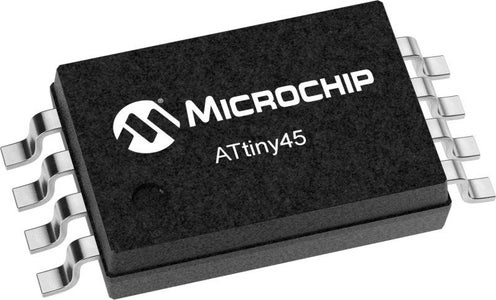

- ATTINY 45

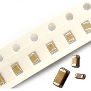

- Capacitor 0.1uf & 1uf (1206)
- Resisrors 10K & 499 ohm (12060

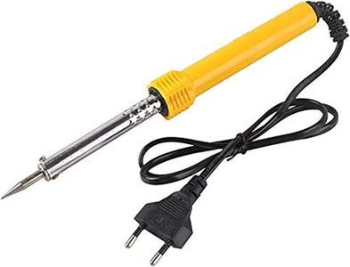

- Soldering iron.

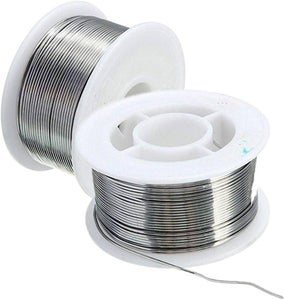

- Solder.

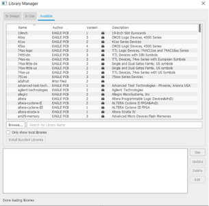

After installation was complete I added a new schematic file. A schematic is a drawing representing connections between electronic components.
Then you should add the components you need to use in my board, so I downloaded fab.lbr library.
Then from the Library bar, select Open library manager and browse the location of the downloaded library then it will be automatically added to the component list.
Using Eagle

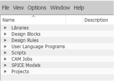

First-time users of EAGLE will be greeted with the rather confusing Eagle Control Panel. You probably expected to see a direct-to-schematic approach, but no, this isn’t a very beginner-friendly application (but it’s very rewarding indeed, so stay tuned)
Start by going to File>New>Project. A new project should appear. You can give it a name, but I chose not to.

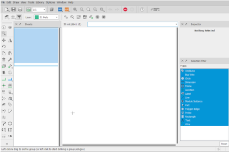

Now go to File>New>Schematic. This will create a new schematic in the project that was currently open.
You will be greeted with another less-than-intuitive window where there is seemingly no way to start drawing a schematic.
You may have clicked the Add Part tool, only to be greeted by a window that shows no components to be added, and probably tried another way, as I did when I first started learning.
In earlier versions, this was more complicated but now you only need to click the Open Library Manager button and go to the Available tab.
You may choose to download all the available libraries, but if you aren’t keen on waiting for 412 (as of May 2019) libraries to download, I recommend searching for the libraries by SparkFun as well as the libraries rcl, linear, transistor-fet, transistor-npn, transistor-pnp, and transistor-power, all in lbr format.

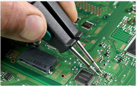

Step 6: Soldering
After you finished the fabrication, I bet you that you can't wait to solder it
it's Easy Steps, but be careful because it needs the Patience to make it Work
1. Bring your PCB And Prepare your Tools
2. Put at first some Solder wire on the track before You put the Component, And then put the component on the solder wire and heat it (to place it).
3. put the solder wire and heat it to place the component
4. Repeat the Previous Step again to place The Resistors
5. Repeat the Previous Steps to Place the LEDs
Note
To know the negative side of the LED, you will See Green Thin line in the LED If you looked closer
6. Put the FTDI Headers & ISP Headers To finish your wiring, and Don't forget to put Resistor Leg in the bottom side of the PCB To Connect the Via
7. Connect the ISP To the Programmer & the FTDI cable to the USB of your laptop

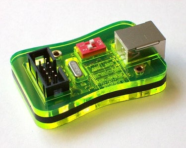

In our case, we will use the ATMEL ICE programmer along with the FTDI to USB converters available in the Lab.
 Luckily You wouldn't Write the Code By yourself, I will give you the code

Download the latest Arduino IDE from their website
Arduino Download
Arduino IDE naturally doesn’t support the microcontroller we are using in the board, so you
should add support for our microcontroller ATtiny45. The first step is to add a link to the support package by going to file->preferences->Additional Boards Manager URLs then paste the
following link :
https://raw.githubusercontent.com/damellis/attiny/ide-1.6.x-boards-manager/package_damellis_attiny_index.json
The next step is installing the support package by going to tools->Boards->Boards Manager
then search for Attiny and click install.
Now we have the Arduino IDE that supports the microcontroller we are using.
The next step would be setting up the controller and the programmer settings.
Go to tools->Boards->ATtinymicrocontrollers->then select Attiny25/45/85.
For the next step go to tools->processor-> then select ATtiny45.
Then go to tools->clock-> then select internal 8 MHz.
The final step is configuring the programmer by going to Tools ->Programmers andthen selecting Atmel ICE (AVR).
Now the Arduino IDE is fully configured and we are ready
And Now click on Sketch and then click on Upload Using Programmer
And here is our PCB Yeah
