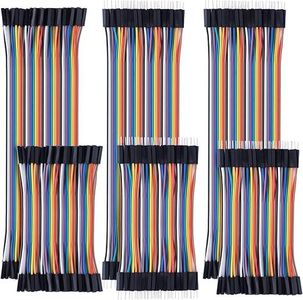

15- Wires (10 female-to-male and 5 male-to-male)
