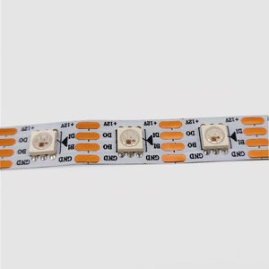

Step 1: Which LEDs to Use?
For this project I decided to use a WS2815 LED-strip with 60 LEDs/m.
- Each LED has a small IC, so we can control every LED's color and brightness individually using the data lines and an Arduino library like "FastLED"
- With the LEDs being in a strip we basically don't have to solder
- They are supplied with 12V DC. This is better than cheaper alternatives like the WS2812B because you need a power supply with less amperage (more in the next step)
- There is a backup data line, if a LED breaks
If you find a suitable power supply (see next step) you could theoretically also use the cheaper WS2812B LED-strip. This has the advantage, that you can power the microcontroller directly and don't need a buck converter for that, but I would recommend using WS2815 so I based my code and instructions on them.

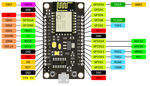

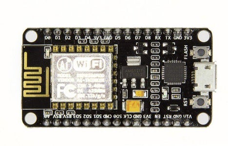

Step 3: Microcontroller
I used a NodeMCU board for this project. It has WiFi, USB to UART (you can program it via USB), and an on-board voltage regulator, so it's fairly easy to work with it. Unfortunately it can't be powered by 12V, so I needed a buck converter to regulate the voltage. In my cased I used one with an USB-output, so i can just use a USB-cable to connect the board.

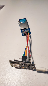

Step 14: Connect the SD Card
I split the electronics part into connecting the SD card to the NodeMCU and connecting the power supply with the LEDs.
We will connect the SD card as follows:
- SD card ➞ NodeMCU
- GND ➞ GND
- 3.3V ➞ 3V
- CS ➞ D8
- MOSI ➞ D7
- SCK ➞ D5
- MISO ➞ D6
I used female - female jumper cables for the connections.

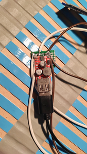

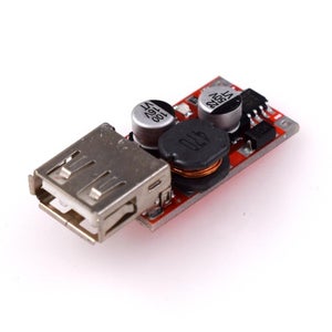

Step 16: Powering the MCU
To power the NodeMCU directly you would need a 3.3V supply. The other way is to power it via 5V on the microUSB port. Either way we will need a step down. I chose the second option and went with a HW-676 featuring an USB output. I connected the + to the 12V of the supply , - to GND and used a short USB cable to connect the NodeMCU.
This already rounds up the electronics part (see the mess i created on the picture above), which only leaves us one thing:

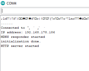

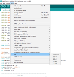

Step 18: Flash the NodeMCU and Prepare the SD Card
Preparing the SD card is very simple: just copy the index.html (can't upload it here, so please use the drive link) into the root directory of the SD card. Flashing is not that straight forward:
- Because the NodeMCU is no official Arduino board you have to add external boardmanagers. If you never used an ESP8266 before or don't even have the ArduinoIDE yet, follow this tutorial: https://create.arduino.cc/projecthub/najad/using-...
- Open the sketch and change the SSID and the password on the top to your WIFI credentials
- Choose the right port under "tools" and hit flash!
- Check the serial monitor for the IP address under which you can find the web app.
- If you encounter any errors feel free to comment, I'll answer asap

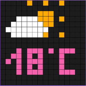

Step 19: Short Introduction to the Web App
When you open the website on the given port you will see this UI. I will give a short explanation of the buttons and functions:
- pen: left click to draw a pixel with the selected color
- eraser: left click to erase a pixel
- bucket: left click to fill areas of the same color with the selected color (wait till it's finished on the matrix before using it again)
- bin: clears the canvas
- save: click to save the current picture
- WIFI: toggles between two modes:
- sync drawing on the web app live to the canvas
- don't sync drawing and display all saved pictures in a loop
- load: select a pattern to be loaded on the web app and matrix
- delete a pattern from the SD card

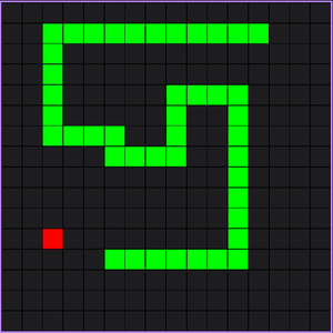

Step 21: Inspiration and Ideas to Expand the Project
Now it's you turn, if you want to expand your matrix , here are a few ideas:
- make it faaaster
- make it responsible and compatible for touch devices
- add a feature to make animations
- add a feature to play games like snake
- let it display something according to the weather
- make it a statusbar for octoprint
- add a motion sensor
- and what else comes to your mind!
