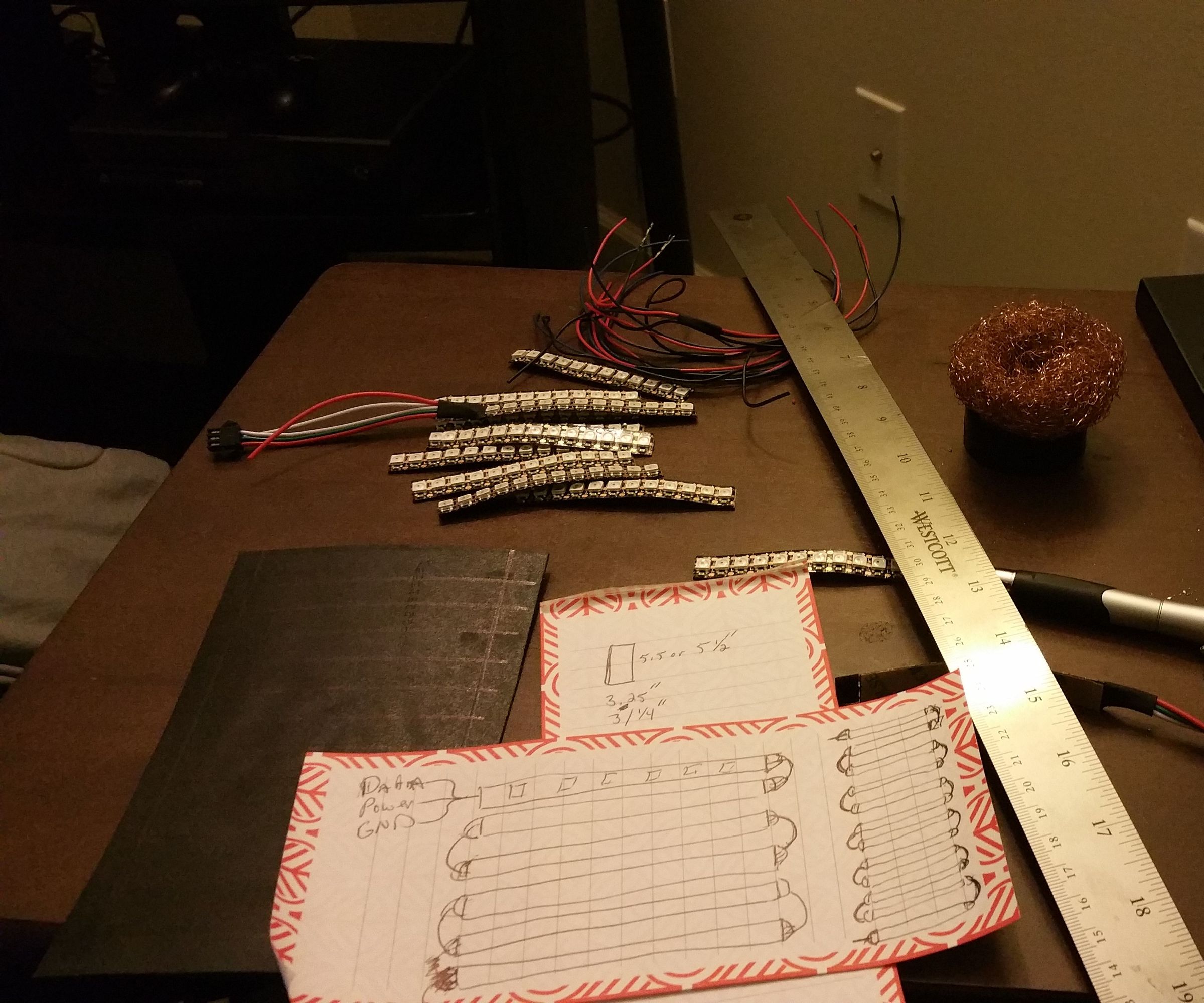

I have taken several steps in order to make my backpack a successful project. I decided to sketch out how I wanted to place the LED's on the bag. I also decided to sketch out the circles that I wanted to incorporate on the bag. I decided that I wanted the LED's to remain connected to illustrate an illuminated chase of light. Here's a list of items needed to build my bag:

I needed to measure the LED's to their corresponding sides of the backpack. I decided that labeling the cut length LED's should be numbered in order to keep there exact placement exact. I drew out the circle and began to cut individual LED sections from the strip and place them an approximate distance in order to make a circle. I also had to solder the power, ground and data wires to each individual LED to create a chain that would then be reconnected to the other two strips that I have now cut and set aside.
