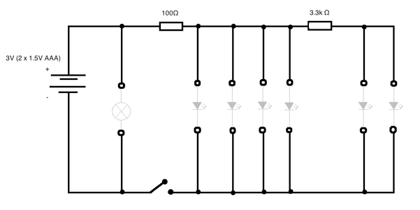

Rather than making only one set of testing terminals for one LED at a time, I made several terminals, so many different types and kinds of LEDs can be tested easily. Some might have very short legs, for example. For that the large plates would be useful. Or you might want to compare some different LEDs, to see which one has brighter colors, for instance. Then you could plug them all into the female sockets next to each other. I also added terminals with a lower current, as some LEDs will burn out with only 100 Ohms. A 3.3k Ohm resistor did the job well.

Then, for the wiring. I made a few mistakes, so don't rely on the photos. Use the schematic instead.
The 100 Ohms resistor is attached to everything but the lightbulb. The lightbulb wouldn't work with 100 Ohms. The 3.3k Ohm resistor is attached to one of the sockets, and the two terminal strips. Those terminals will be used for any low-current LEDs.
