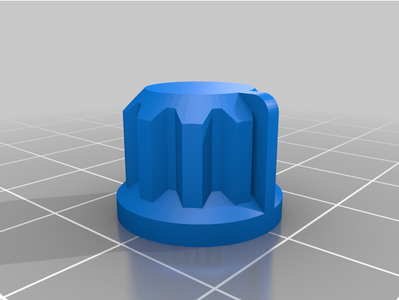

I also included the file for the potentiometer knobs I 3D printed, it was found at: https://www.thingiverse.com/thing:4725626
These are totally optional, but can add a nice touch if you have access to a 3D printer! These are your last step in the assembly if you decide to add them!
