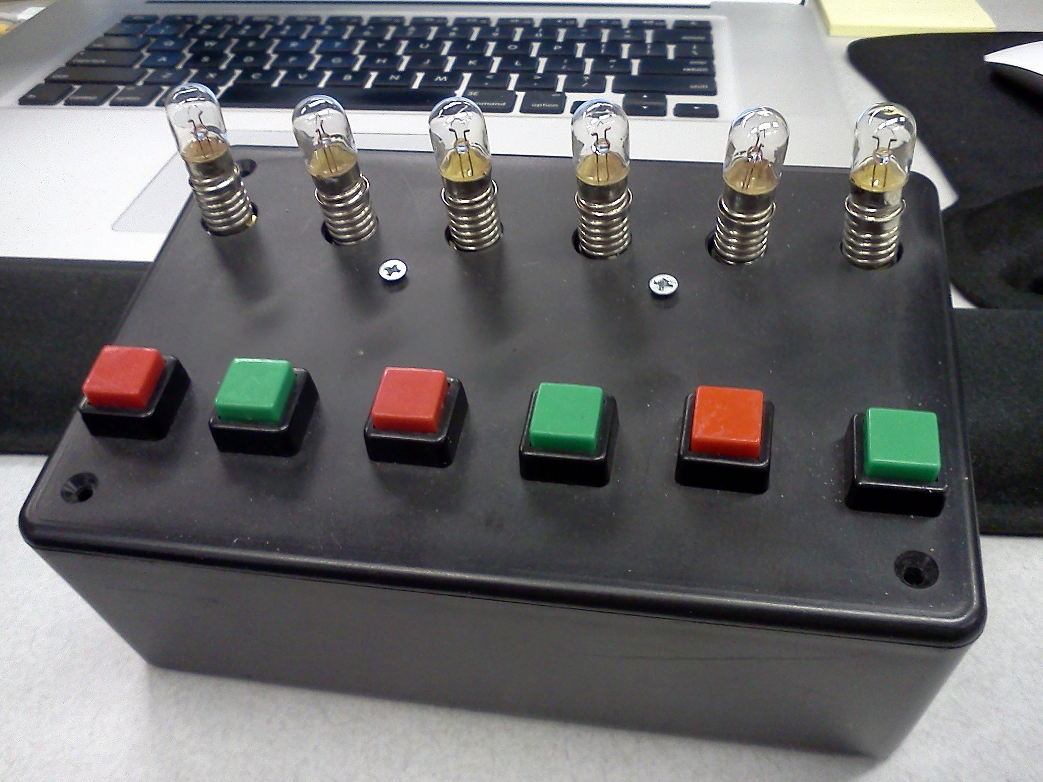

I'm building a similar project for my son to play with. Mine uses 3 LEDs (Red, White and Blue) and 3 switches. Each switch is supposed to turn on one light, and they are supposed to each work independently, but run off of the same power source (9v battery, likely). I can't seem to get the wiring right, and I was wondering if you could help. The LEDs I'm using are these:
http://www.radioshack.com/product/index.jsp?productId=3125355
http://www.radioshack.com/product/index.jsp?productId=3111495
http://www.radioshack.com/product/index.jsp?productId=3096133
I need to know how to wire them to make them work independently with their respective switches and what value resistors to use (and where to put them for that matter). The total voltage requirement for all 3 on at once should be about 8-8.5v, so a 9v battery should work. I'm not worried about changing it out when it's dead, I just want this to work! I'm usually pretty good with electronics, but this one is driving me nuts! Thanks in advance for any help...

There are some handy LED/Resistor calculators online, just google "LED Resistor calculator". Using one, I've determined that you'll want 3, 330 ohm, 1/4 watt resistors. Attached is a schematic as best as I can tell from your description.
Good luck and have fun! :-)

Thank you so much for your time...my only question is that wouldn't the resistor values have to be different since the FV on each LED is different? I couldn't find a resistor calculator that let you put in more than one LED voltage, so I wasn't sure if this would work. I'll give it a shot though and let you know how it goes!

Thanks again for your help...It works! Not shown: I had to cut out a piece of old sponge and glue it to the back plate to hold the 9v in place so it doesn't rattle around, but here's some (sideways?) photos. Oh, and the boy loves it too!

Love it. It's a lot like the first one I built. Watch out though, if your boy is like mine, he'll grow tired of it and then you'll be making another one more complicated. ;-)
After I built the one spelling his name and he got tired of it, I just broke down and bought him a set of "snap circuits". He LOVES them. Cheers!
