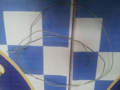

Step 4: The Holder
Wrap the wire around a cylindrical object like a pen.wrap the end of the wire around something larger to make the holder head.

Step 7: Strengthening the Wire(optional)
If you are using wire of low strength, there is a chance that it can't support the weight of the Torch piece and will bend.Supporting it with epoxy is a good idea. apply epoxy only halfway up.
