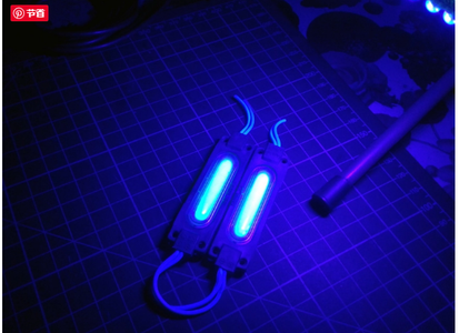

For the first test, I placed a pair of green COB LED sticks (unpowered of course) on a black cutting mat and illuminated it with UV light from a distance of about 20cm. Below you can see the "fluorescent" results of an experiment run under my basic 395nm black light engine. Great, isn't it?
