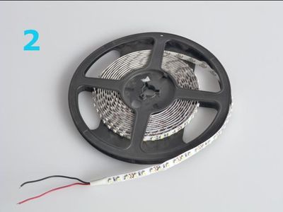

Photo2: Roll with LED string, total length 3.5 m .The LED string is at 12V, 120LEDs / m, cold white.

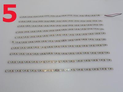

From the roll with the row of LEDs we will cut in the places specially provided for this a number of 10 rows of 35cm. every.
Each string will contain 42 LEDs that are grouped by 3 series LEDs with a limiting resistor. The LED strings will be powered at 12V, all in parallel.See photo 5.
Of these 10 strings, 9 will be mounted on the support, and one will be kept as a spare.

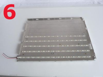

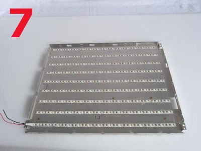

The sheet metal support will be well cleaned with thinner and 9 parallel lines will be drawn (distance 3 cm. between them), as in photo 6.
Peel off the protective foil from the back of the LED strings and, using their self-adhesive property, glue them over the previously drawn lines. See photo 7.
