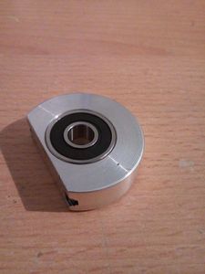

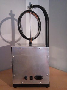

Step 2: Housing and the Ring
Housing is made from 2x2 cm square metal pipe.
The ring is end piece of PVC pipe, and it have 64 3mm holes for LEDs and two 10mm for shaft.
After painting and drilling i put it all together. On top is metal bearing, and on lower side is conected on the motor.

Step 4: Slip Ring
Slip ring is used for powering the shaft, it's easiest way to do it. Just be careful! It needs to be centered or you'll have breaks in power transfer. Because of this, your Globe won't work, so you'll need to put capacitor as big as you can buy.
Step 5: Putting All Together
Arduino Uno and PCB with shift registers are placed on fiberglass on the shaft. 5V DV power and PWM are in housing. You have only 3 wires from arduino to the shift registers PCB. LEDs and Arduino have the same source od power supply.
