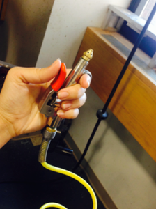

- Remember to use the air hose to keep the end mill free of debris.
