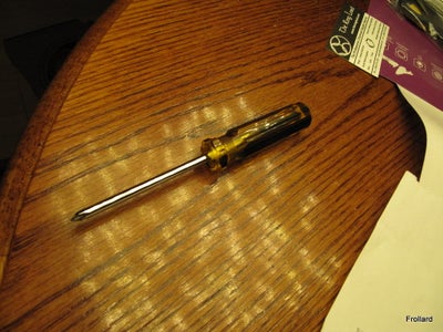

Pokey instrument - I used a philips screwdriver.

2. Gently poke holes through at each point of the squares - just enough to break the surface on the other side. The philips head was really good for this - its a natural borne boring tool!
3. Punch them again, from the GOOD side to make pretty round holes.
