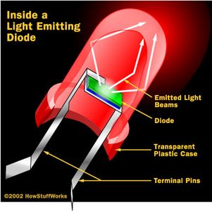

Ever soldered a LED into your project backwards? It can really mess up a good day!
If you don't know, LED's have a positive side and a negative side, and will only light up when wired correctly. Most LED's have one longer lead to indicate the polarity, but not all. Here's a simple solution to find the correct side BEFORE installing it into your project.

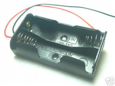

Step 1: Equiptment List
1: 2AA battery pack. Can be found on eBay for about $10 for 12

Step 2: What to Do
1. Strip the ends of the two leads coming from the battery holder. 2. Insert batteries.

Step 3: How to Use
1. Stick your LED in question to the wires, note which wire is + and which is -
2. Install your LED into your project correctly the first time.
