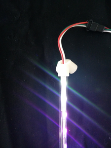

Step 3: Cut the Output Parts of Led Strips ( Length 310mm, 20 Leds) and Solder the Led Strip Repaired Board to It.
Step 4: Solder the Led Repaired Board to the Rest of the Led Strip. and Solder the Wires to the Long Strip.
Step 5: 3D Print the 3ways Elbows and Caps
Step 6:
Step 7: Insert the Led Strips in to the Elbows and the Acrylic Tube to Make the Pyramid
Step 8: Connect the Blinkytape Controller to the LED Strip With JST Connector
