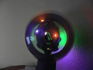

The device is a three gimbol induction coil LED light spinner, what you see above is the concept model, below you will find a more refined, motorised version.
All I can say is it looks pretty in the dark! :)

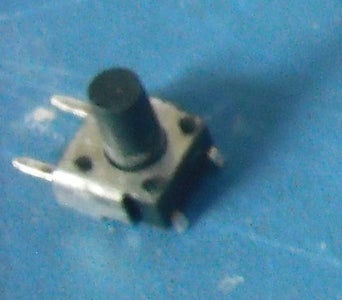

Miniature "press to make" momentary push button

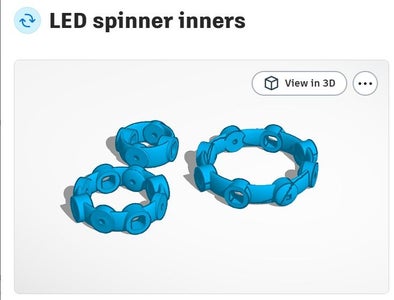

Step 1: Nesting LED Spinners
In TinkerCad three nesting rings were designed with pockets for the LED lights and 2mm holes for spindles, one of which in the largest ring is a 2mm square hole for the motor shaft..
The red lines show the pivot positions, they are placed to cause an imbalance when spun. The LED's were glued in place with super glue..
The pivots were cut and the ends were deburred
The centre pin is 40mm long, the 2 off outer to middle pivots are 10mm long, these were inserted and fixed in place with a dab of superglue at one end.
The motor output shaft will be at the 6:00 o'clock position. The long pin shown at the 12:00 o'clock position is 16mm long, one end is hammered flat to locate it in the cage, the clear plastic globe will keep it in place and allow for disassembly..
LED spinner inners for LED's

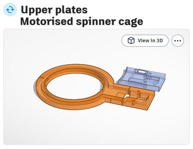

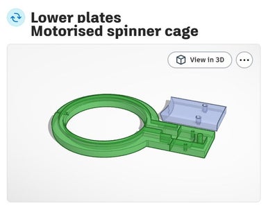

Step 2: Spinner Cage 3D Printing
3D resin prints of the four parts that make up the spinner cage were produced and trial assembled (including the motor/gearbox), after a few minor adjustments, taking off sharp corners etc, it all fits together neatly.
Lower plates Motorised spinner cage
Upper plates Motorised spinner cage

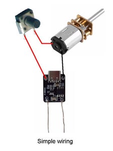

Step 5: Wiring It Up
The PCB for the coil has provision for an external power supply with + & - solder pads placed on either side of the USB socket, I soldered wires to the contact points to attach the switch and motor.

The concept spinner could easily lay flat if put down, on the reworked model the motor stops where it stops so it more often than not leaves the spinners sticking out from the cage. For protection I went for a two piece clear plastic ball of the type used for Christmas tree decoration.

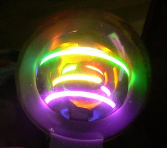

Step 7: Final Assembly

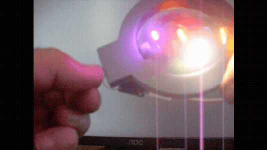

Once the wiring was complete the 4 parts of the cage were assembled with M2 x 20mm screws and nuts and the 2 part globe was clicked together around the spinners. Plugging in the USB lights the LED's, pressing the button makes the LED's move. Sorry about the poor quality GIF. I am reduced to taking pictures and video on a potato :(
