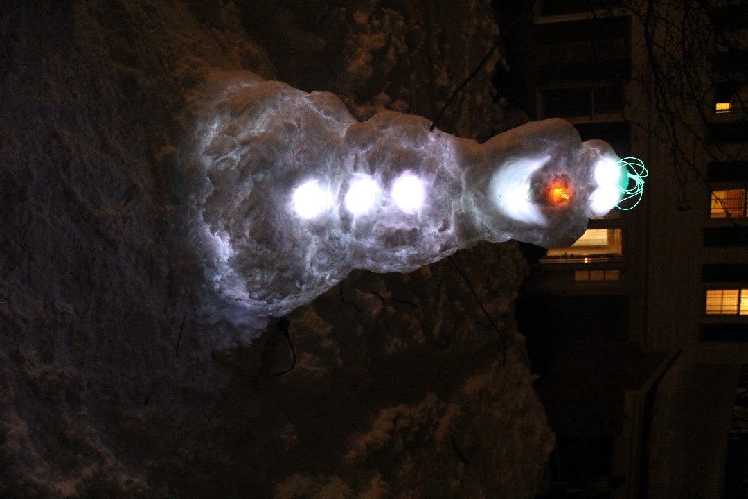

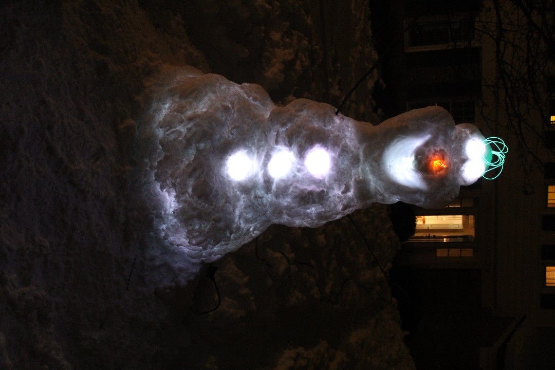

Step 5: Introducing Olaf the LED Snowman
Just some snapshots of LED Olaf.
