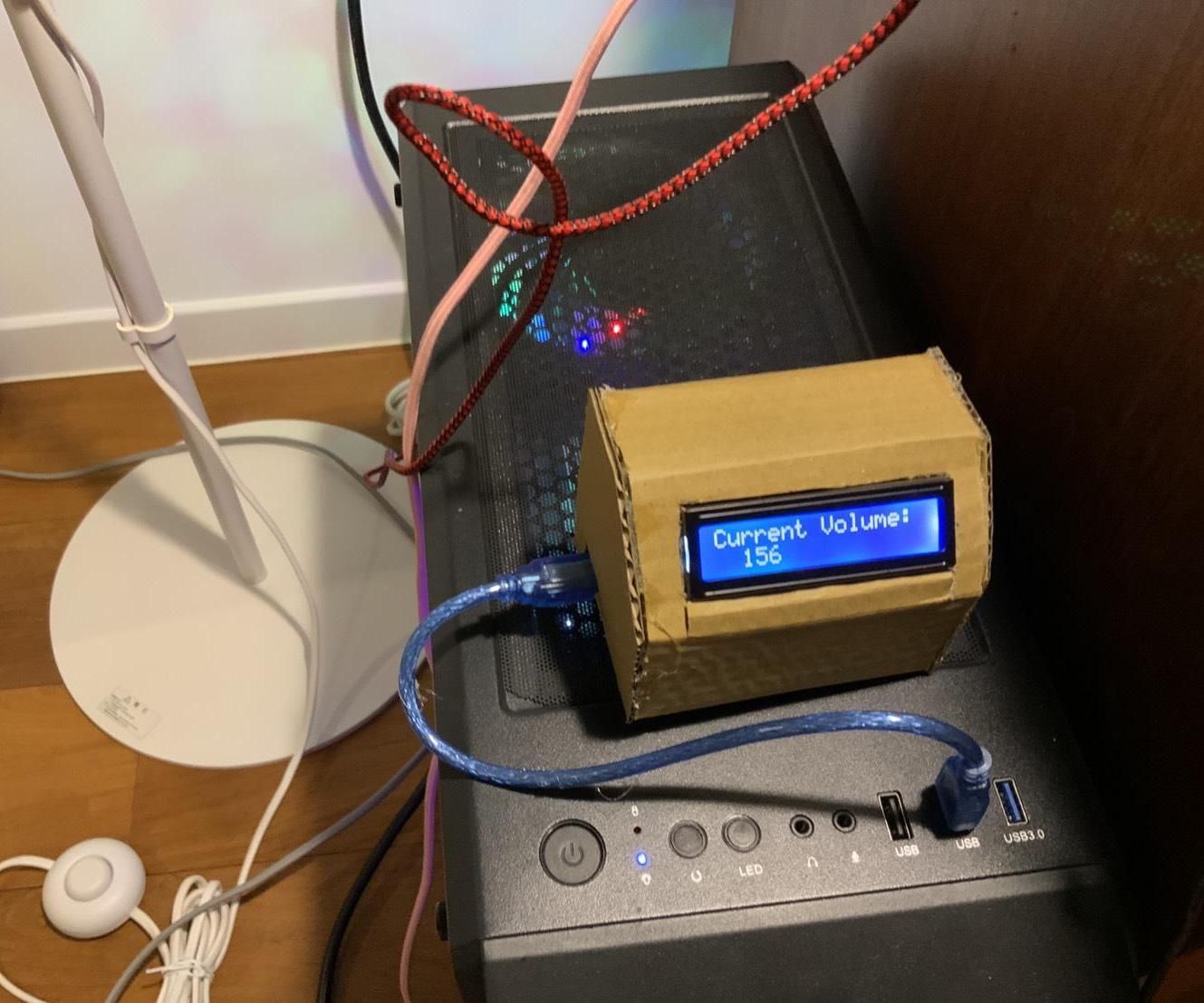

The LED Reminder Light helps you remember to bring things by lighting them up with a big red beacon. The device attaches to a bag strap or the like, and lights up with a red light at a set time every day. When you awake, the light will be there, reminding you to grab your bag. Once you’ve done that, you can just pull the device off , and it’ll turn itself off in a couple minutes.
The red coloring of the LED is on purpose: the light is the least harmful to the human eye, making it a good choice for when you’ve just woken up and need a reminder, as blue light would be eye-piercing and harmful.
See above pictures.
