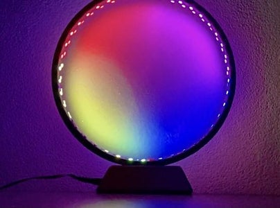

Introduction: LED Ringlamp 2.0 With WS2812B Led Strip
Here I present you my self-made LED Ringlamp 2.0 with WS2812B Led Strip
You can find the structure in the steps.

Step 1: 3D Printing
At first I 3D printed some parts for my Ringlamp
This time I made the parts a bit more ergonomic,because the lower part (bottom / lid stl.) Looked quite chunky
-> Bottum case / lid (4.hours)
-> Ring (7 hours)

Step 4: Soldering
First I soldered the 2 3 pin cables together and finally soldered the 2 ends to the respective Led strip. I soldered the other end to the stripped controller cable.
Step 5: Glue the LED Strip Into the Ring
A hot glue gun is very helpful in this step, as the adhesive strip sometimes does not hold or open well.
Step 6: Put Everything Together and Accommodate
Now you have to thread the cable through the technical housing and stow everything well. The output of the controller must be attached to the hole in the housing (hot glue)
Step 7: Finally, Screw the Screws Into the Bottom of the House
Step 8: Finish
