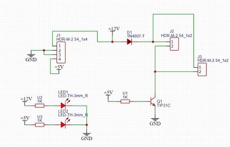

Step 1: SCHEMATIC DIAGRAM
Here we will see the schematic diagram made in the easyeda software with all the electronic components and their respective values.
Step 2: FUNCTIONING
This circuit is powered with 12VDC and the control with 5VDC with indicator LEDs that are at these voltages that come from the electronic card and we can control 2 independent LED strips, a very easy circuit to make and with few electronic components.

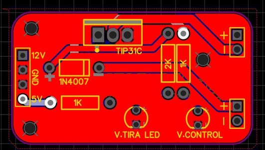

Step 5: EASYEDA
This project was made in the Easyeda software as we can see the tracks and the 3D image of the project working perfectly are no difficulty
