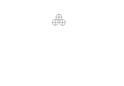

Step 4: Making the Frame
In step 4 I will show you how to make the frame so you can make the LED formation,link . One LED formation makes one LED snake link. I made the blueprint in a program called Electronic Symbols. (picture 1)
First you have to download the document and print it out, I made it in several formats. The blueprint consists of three 10mm circles separated by 1mm, making a triangle shape. (you can download the blueprint in tiff, picture 2 ; jpg, picture 3 and as a ;word document)
Download the blueprint, print it out, and using some wood glue apply it to the wooden board.
Take the electric drill and the 10mm drill and make the 3 holes in the wood, try to do it precisely as possible. That is why you glued the printed blueprint,so it would be precise.
You should get something that looks like in picture 4 and 5. Mark the paper just like in the picture 4 and 5, the left plus (+) is facing the right plus (+) and the left minus (-) is facing the right minus (-). As for the LED on top, the left side is a plus (+) and the right side is the minus (-)
Make shore that the LEDs fit inside the holes perfectly! (picture 6 and 7)
