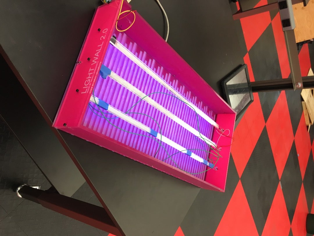

I really liked Dan Chen's Instructable Ex Machina Sound Reactive LED Wall. It was so easy to follow, and the results were great. I created version using cardboard and vellum, as you can see in the image with the red LED lights in the middle - note the Arduino and breadboard hanging off the side.
The temporary version was great, but in this Instructable, I've simply taken Dan's idea (along with his Arduino code) and created a more permanent sound reactive light box. The design are simple translucent bars, created by the laser cutter to allow light to penetrate from the box. Let's get started.

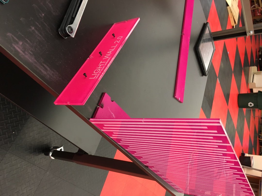

Here are the .dxf files for you to laser cut. You will need (3) of the rails that hold the LEDs, (2) of the short sides, and (1) each of the face, top, and bottom.

Step 4: Assemble the Box

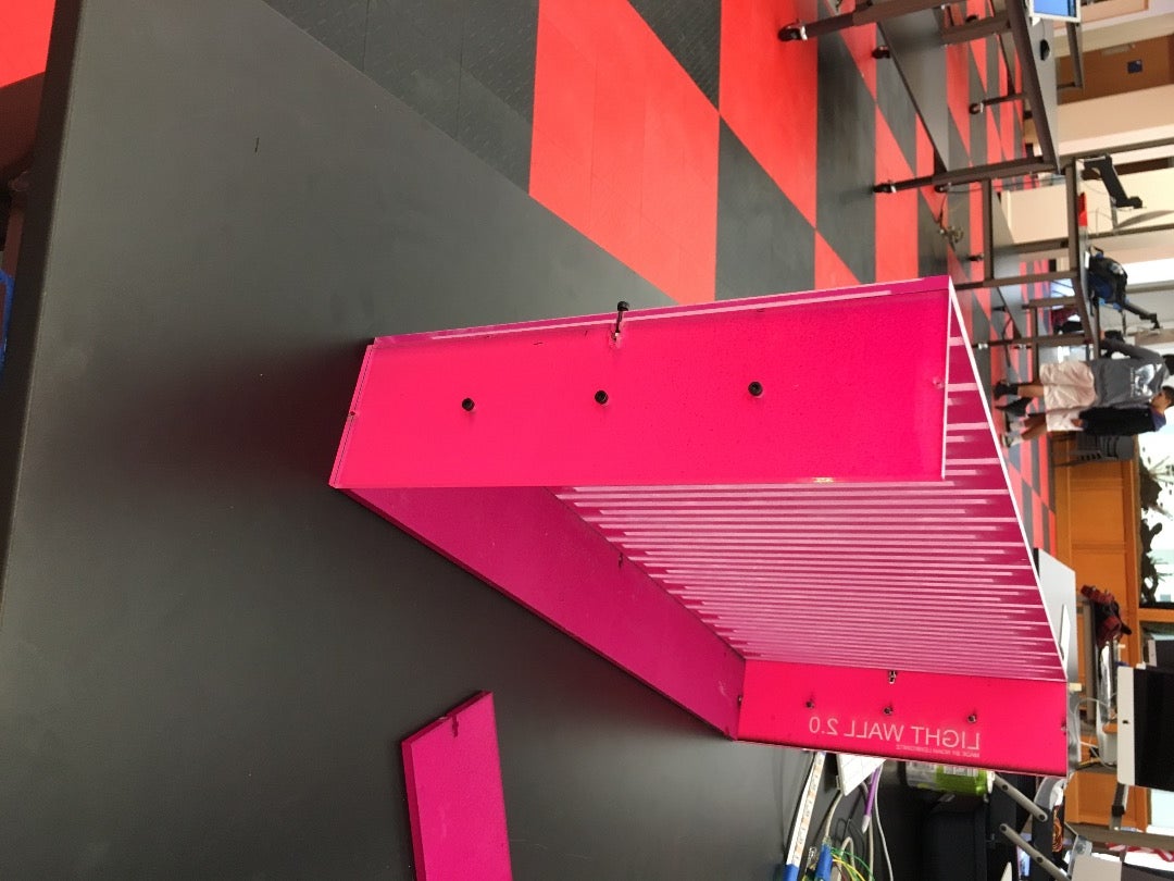

I used a T socket style system to connect the different parts of the box together. This was the system used on the old Makerbot Thing-o-Matics to connect the wooden side panels, and I always liked the simplicity of it. Simply slide a nut into the groove, and then attach a bold through the laser cut hole to connect two pieces of acrylic together. When tightening, do so carefully, you do not want to over tighten and crack the acrylic.
I started with attaching the face to the bottom piece first, then the sides, and finally the top.You will notice in the photos above their are 3 bolts in each side piece, these are to hold on the rails for the leds, which we will talk about in a few steps.

Check your LED strings to make sure they are all working correctly. They should be flashing the same colors, in my case blue and violet, when the sound sensor is activated. Carefully remove the adhesive backing from the LED strip and attach it to the rail. Do this for all 3 strips first before installing.
To install, it is best to insert your M3 screw first into the holes in the side panels of the box and loosely attach a nut to each screw. Lay the light box face side down, so that you are looking into the back of the unit. Slide one end of the rail onto the nut and tighten the screw to hold it in place, then repeat for the other side of the rail. This part was a little tricky, as the rails would slip out of the T slot if not tightened enough when going to attach the other end. A little back and forth and I got everything put together.
Step 7: Let It Roll!
Give it one more test and then hot glue or tape down your Arduino and sound sensor to the bottom panel and you are ready to go. Plug the Arduino into your computer and turn up the sound!
